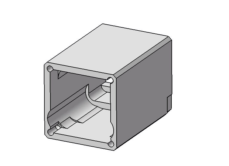

Hi there,
I have designed an aluminium alloy capsules to house some electronics. They are also in between the active cooling system and another part we want to cool down.
Its function is double: on one hand, it shields the electronics from electromagnetic noise and on the other, it conducts the heat.
It doesn't have mechanical/supporting responsibility. Although there are few small threaded holes (M2) and it will be machinned (milling)
What alloy should I use? Shall I go with the purest aluminium possible?
Checking online the best options are 1050A or 6060
Any recommendations?
We plan to go to mass production so price is also important
thank you in advance

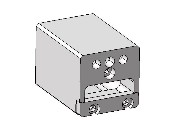

What aluminiums are easier to machine? between the ones we have discussed: 1050, 1100 and 6060? There will be M2 threaded holes.
the capsule has an outer box dimmensions of 1 x 1 x 1.4 inches3 - 25 x 25 x 35 mm3
There are few CNC operations to perform, here some pictures:

Your CNC shop will be happier with the 6xxx alloys in heat treated form (T6 temper or similar). The 1xxx alloys do not machine as well, being softer and "gummier" (high ductility) and leave larger burrs behind that they will have to deal with.
