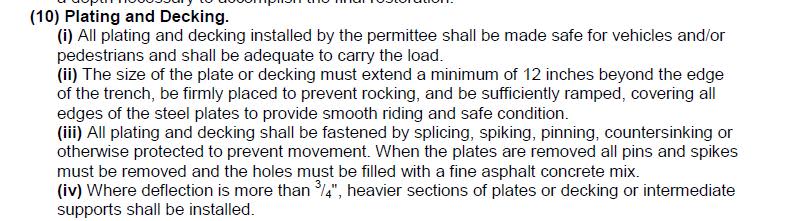

Here's a blurb from NYCDOT Highway Rules Section 2:
Under 10 (iii) it states "...spiking, pinning,..." On bridge decks I've seen railroad spikes used, on city streets they're generally not pinned down. Contractors will put a lot of blacktop to keep them in place.
Also, I attached a Caltrans spec; similar to NYCDOT but a little more definitive.
