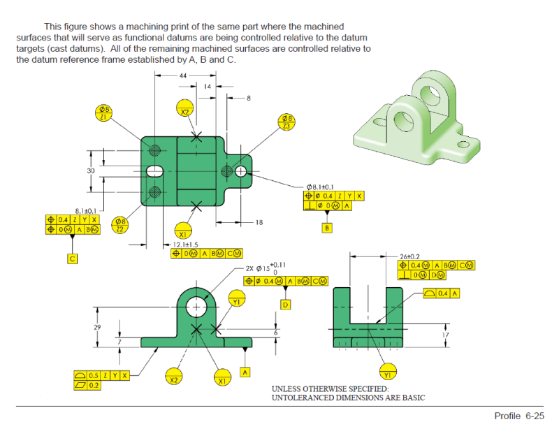

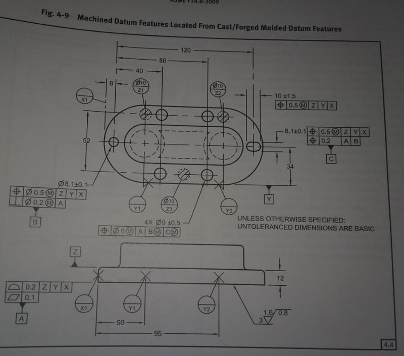

A part similar to the one shown ASME Y14.8-2009 Fig 4-9 (page 28). (Casting Standard)
The one and important difference is that there is an “as –cast” hole thru the part that is not used as a datum feature on the machined drawing.
On the machined drawing: Casting datums and machined datums are shown similar to the datum scheme above. The hole in question (again, as–cast hole/feature) is dimensioned and toleranced from the casting datums and ALSO from the machining datums.
Pos 0.8(MMC) Z, Y, X
Pos 0.25 A, B, C
Z, Y, X- casting datum targets
A, B, C machined datums
Some design/product engineers are seeing this as double dimensioning, others as illegal or redundant and others are just in agreement with this scheme.
The intent is to avoid the “as-cast” hole/feature to be out of “functional specification” before the part is used in the assembly. Since the hole is “as-cast” and does not get machined Z, Y X datum scheme is needed, but deformation of the part during the removal of the material has also been noticed.
I have no much experience with casting and plastic parts, but learning…..
On Tec-Ease I’ve seen a similar example, but again, no “as-cast” hole / feature dimensioned from the casting datums and also from the machined datums (except the initial datum targets that are shown and described /become on the drawing machined datums feature). See attachment for Tec-Ease example.
On Tec-Ease example, lets say Ø15 holes is "as-cast" and is also dimensioned WRT to Z, y and X in addition the the current position Ø 0.4 to A, B(M) and C(M) shown. How you you see it? Double dimensioning, illegal (per the standard), redundant, correct or other?

Some will complain that there's no specific machining operation and therefore the machinists should not get dinged if the cast feature is out of tolerance. If there's any sense to it they would not be and failing the part at any level should have a correct failure analysis.
There are others who point out that if the feature is that critical that it needs to be inspected that it should be machined and not left to drift up from a lower fabrication level.
I would only do this if the lower level feature was used as a datum reference and the dimensions and tolerances were needed to establish the datum.
RE: Double dimensioning, illegal, redundant, correct or other
The holes/features were good when the casting has been delivered/measured versus we didn’t touch the holes/features?
Is this a potential solution?
Looks like the agreement is not achieved yet.
What other solutions, from your experience, could be used? What else could be done to not spend much $$$ in lengthy debates an unproductive discussions ?
Again, I am looking for peoples experience in this area of expertise.

The "machined drawing" is serving as the finished part drawing, correct? If so, and if there is a corresponding functional requirement, I'd say it's perfectly reasonable to apply a tolerance to a cast feature that references a machined datum feature. Ideally, the casting drawing would have a tighter tolerance for that same feature, referencing cast datum features that will eventually be used to establish the relationship between the casting and the machined datum features.
I don't understand the purpose of the 0.8(M) position tolerance that is applied to the same feature but references the cast datum features on the "machined drawing". Is that intended to cover some separate functional requirement of the finished part?
If you have some strange drawing structure where dimensional requirements on the casting drawing somehow apply to the finished (machined) part, then much of what I said above may not apply. I've never come across such a scheme.
If I am designing a part that I intend to be manufacturable by casting and subsequent machining, I will generally design the finished part first. Based on that finished part design and the details of the planned manufacturing process, someone (who may or may not be me) will then design the casting.
Wherever practical, I'd recommend the finished part drawing allow machining on features that are generally intended to be cast. This keeps options open for manufacturing.
pylfrm
Yes, correct.
Has been decided (long before my time) that due to some economic reasons some holes/ features to be manufactured “as-cast”. (was good enough)
Then, if they were “as-cast” the decision has been made to have them toleranced from the “as-cast” datums (again, on the machining drawing). The main argument was: manufacturing is not touching them and has no intent to change their size/ location/ orientation/form. Again, “no intent”...........
Well, all was good until after the machining process has been noticed that these “as-cast” holes and features are no longer where they need to be, based on the casting datums (Z, Y and X).
Solution: Another ECN has been run and a positional callout (for the holes) has been added on the machining drawing with tighter tolerance from the machined datums A,B and C. And the argument was the deflection of the part during manufacturing. (please note that the position from the casting DRF was not removed or changed)
To show the “as-cast” holes on the machining drawing is legal (I guess) because the casting datums are (already) shown on the machining drawing (that is a standard requirement), pretty much in the same way as it is shown in the standard and also on Tec-Ease example embedded (casting DRF’s are on machining drawing).
Now, as I stated before, some will consider this approach “double dimensioning”.........(same as the title on the thread)

It sounds like this tolerance probably does not reflect any functional requirement of the finished part. If so, I'd say the tolerance should be eliminated. Do you agree?
What diameter tolerance is applied to the hole on each of the two drawings?
What position tolerances are applied to the hole on the casting drawing? What datum feature references are used, and how do they relate to those used on the finished part drawing?
Does the machining process use datum features X, Y, and Z (as defined on the finished part drawing) to establish the relationship between the casting and the machined datum features? If some other method is used, please explain.
pylfrm
See the sketch for "conceptually" the same part as the one in question.
Here are the answers for your questions:
Imagine fig 4-9 (14.8-2009) but the part is round (not oval shape)
Datum target Z (3) as shown on the face of the part.
Datum target Y the OD
Datum target a width of a slot.
Blue holes” as cast”
Same size tolerance applied on each hole on each of the two drawings (casting and machining)
Positional tolerance on the machining drawing
Pos Ø 0.8(MMC) Z, Y, X
Pos Ø 0.25 A, B, C
Positional tolerance on the casting drawing

Are you aware that there is something wrong with the follow statement?
"Same size tolerance applied on each hole on each of the two drawings (casting and machining)."
The blue holes are not created on the machining drawing, therefore they should not have positional tolerances. If you really want, you may add reference dimensions.
No dimension with tolerance may appear more than once for any given feature.
The print shown is the machined print.
We are not talking about the "as cast" print or part or casting drawing. We are only talking about the "as cast" holes on the machined drawing.
Yes, but also goes to the machined drawing as "as-cast" holes.
There are only two things you do to "as cast" holes on the machined drawing:
1) Select them as datum features or dimension machined features to them;
2) Add reference dimensions to show their sizes and locations to other "as cast" features. (Not recommended)
Well, in the picture embedded Fig. 4-9, (which by the way it is from the casting standard) it is shown a feature (on a machined drawing) that is neither of your two options.
On the machined drawing, the length of the oval slot 10±1.5 is shown from the casting datums Z, Y and X.
I guess the standard does not fit your theory or your theory is not in agreement with the current standard. The length of the slot is NOT a datum feature (the width is) nor is shown as reference.
There are only two things you can do to "as cast" holes or features on the machined drawing:
I see Fig. 4-9 does neither of the items above.
Please pay attention to "two things you can do to as-cast holes or features".
On the machining drawing, you (cutter) do not touch the 3 blue holes.

Okay. So, you think that Pos Ø 0.8(MMC) Z, Y, X –for “as-cast” holes, should be eliminated from the machining drawing?
Again, to be kept on the casting drawing (maybe with even tighter tolerance than the current specification of Ø0.8 (MMC) to make sure the functional tolerances at the machining level are setup for success… I know we did not talk about the casting drawing at all), but it is useless of the machining drawing even the holes are “as-cast”?
And to answer your last question:
As far as how the machining process goes, I don’t have much experience in that area, but all I can tell (if make any sense for the people with manufacturing experience) is the following:
- First machining step: datum feature A (bottom flat surface). Part is held/centered on some “as-cast” surfaces (three small ribs/ protrusions) and the chuck is contacting datum feature Z in three area.
- Then, the second step is the OD, datum feature Y (same setup as step 1). Please don’t ask me for speeds and feeds as I have no idea.
- Third step, different setup/machine: Drilling datum feature B and machining C, with the part sitting on A, centered on Y and clocked on X.
pylfrm,
Does my explanation help? Did I answer all of your questions? Thank you again for your help.

So, the requirement is Ø 0.8 (at MMC) for the casting holes at the machining level.
Then at LMC (biggest holes) the max pos. is Ø 5.8 (2x 2.5 +0.8) , correct? (per the OP drawing: holes size Ø7.8 ± 2.5)
Where 10.8 is coming from?
On the RFS should be 0.25 RFS to A, B and C. How I can relate both callouts with 10.8, I do not know yet. Could you, please, give me a hint?

Jassco,
I did consult 14.8 and in the picture embedded Fig. 4-9, (from Y14.8 casting standard) it is shown a feature (on a machined drawing) 10±1.5 from the casting datums Z, Y and X.
Can you conclude then, that the length 10±1.5 is “as-cast” and its applicable width 8.1±0.1 is machined? Or both features (length and width) are machined? Or both are "as-cast" ?
On the machined drawing shown:
- the length of the oval slot 10±1.5 is shown from the casting datums Z, Y and X and
- in the meantime the width 8.1±0.1 is shown from both “casting” and “machining” datums
Could you, please explain your point a little bit better with no disagreement with what is currently shown in the standard you mentioned Y14.8.
Thank you

Per ASME Y14.8, there are 3 methods to present drawings for cast item, namely:
1. Separate view drawing method;
2. Combined view drawing method;
3. End item drawing method.
Fig. 4-9 on ASME Y14.8 shows a 2nd drawing for machining features using "Separate view drawing method". The first would be a drawing for the as-cast item which Fig. 4-9 does not show it. As-cast item will be "material" to make the machined item.
The print does not tell you (and is not supposed to tell you) if this item is casted or machine. If you cast this item and can meet its requirements, then you don't need to machine it.
To answer your questions, the hole (labelled as datum feature B) and the slot (labelled as datum feature C) are machined here. Datum features X, Y, and Z are by default datum features on cast item, while datum features A, B, and C are for machined features. I think you are hung by this statement, i.e., the width dimension 8.1±0.1 is shown from both “casting” and “machining” datums. These two features (hole and slot) are located to datum Z, Y, and X. Datum A and B are merely there for qualification purpose. It basically tell us that machined datums A, B, and C need to be machined on a single setup. It is a qualification process of datum features to make sure they are of quality datums.
Best regards,
Alex

Well, I am also hung by the fact that the length of the slot (10±1.5) (again the length and NOT the width) is shown / defined based ONLY on the casting datums.
I understand the definition of the machined datums (specially datum feature B=the hole-and datum feature C=the width of the slot), but the length of the slot remains unclear (at least in my mind).
Since it is shown from the casting datums ONLY, should I conclude that will be “as-cast” (same it is shown in my application)? Yes, no, maybe? If no, why not?
Thank you again for your patience
The slot is a machined feature. How do I know that? Because dimensions and tolerances for this feature is on this print for machining (Fig. 4-9). Otherwise, they will be placed on another print for as-cast part which will be "material" for this as-machined part (Fig. 4-9).
The print basically tells you to machine A, B, and C in reference to X, Y, and Z (with a single setup).

Then the follow up question is why the length of the slot is defined in the standard only based on the casting datums (Z, Y and X) and not based on the machining datums A, B and C?
What could be a good reason to have this kind of example in the standard which suppose to be "the letter of the law" ?
The width is given a coarse location and orientation relative to ZYX and then a refinement in location and orientation relative to AB.
The slot is not a cast slot. It is only controlled from cast features.

Nothing wrong with Fig. 4-9 on ASME Y14.8. The issue is how you understand it.
First of all, you need to understand that position tolerance of "tp 0.5 MMC | Z | Y | X " does not refer to slot length but rather center plane (a derived medium plane, technically using Y14.5 language) of the slot in vertical direction. 10.5+/-1.5 is just an FOS (feature of size) which is not supposed to have datums.
Design intents of this part dictate that the hole (8.1+/-0.1), the slot (10+/-1.5) x (8.1+/-0.1), and datum feature A are made in reference of datum features Z, Y, and X. Therefore, datum features Z, Y, and X are used.
If you make the derived medium plane of the slot (10+/-1.5) reference to datum features A, B, and C, it is essentially like a dog traces its own tail, as this derived medium plane is part of the slot itself. In another word, position of slot is created by the slot.
Is it OK to use "tp 0.5 MMC | A | B | C| " for length of the slot instead of "tp 0.5 MMC | Z | Y | X "? Yes, but not elegantly. I think John-Paul Belanger or Evan Janeshewski have better qualifications to answer this question than I do.
Best regards,
Alex

aniiben,
The slot (with width as datum feature C) in Fig. 4-9 is almost certainly intended to be machined. However, that does not mean it would be impossible to produce it by casting, even if datum features A and B were machined. An actual drawing may have requirements that rule this out, but none were included in the figure.
pylfrm

Obviously, to show machined datums A, B and C for the same feature (length 10±1.5) is acceptable and fully agreed by Y14.5, so no need to be shown on Y14.8 again.
But, probably the committee wanted to emphasize that showing casting datums on a machined drawing (and the applicable features where those casting datums are shown , are NOT machined datum features) is an accepted option/ in fully agreement with the casting Y14.8 standard.
Interestingly enough, in Y14.8-1996 machining datum reference frame (4.4) wording has the word “should”, which is kept in Y14.8-2009 with one additional sentence added:
“The initial datum targets shall be shown and described on the drawing showing the machined features. See Fig. 4-9.”
The location of the length of the slot from (the casting datums) stayed unchanged.
So, again, I guess (unless I am missing something) that is a valid option (even does not looks like the most logical one).
