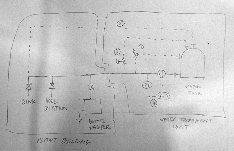

Hello friends, I am planning a water distribution system for a small plant. There are a number of machines that use water (ie. continuously if machine is on), and there are a number of sinks and hose stations which may be opened at any moment for an arbitrary length of time.
What are some of the typical ways to control supplying water to this mix of users? Here is what I can think of:
1. Have the supply pump be on 100% of the time and install an overpressure valve at the pump outlet that sends pump output back into the water tank. This way the pressure in the supply line is always equal to (or less than) the rating of the overpressure valve.
2. Have the supply pump be on 100% of the time and pump water in a loop around the plant that leads back into the water tank. This way the supply line is always pressurized at the pressure that the pump can deliver. (Naturally, this value would be chosen wisely).
3. Have the supply pump be on 100% of the time and have a control valve at pump outlet that sends the output of the pump back into the water tank depending on the pressure in the line. Using PID control, the pressure in the supply line would be kept constant.
4. Install a pressure switch on the pump outlet such that if someone opens a valve (or machine turns on), the pressure in the line will fall and the pump will turn on (maybe with inverter control). Pump would turn off when the pressure in the line spikes as the valve is eventually closed.
I experimented with #4 a bit, but found that in real life the line does not stay pressurized, but rather falls to low values (~0.5 barg) fairly quickly once the pump is turned off.

Do you have a PFD or P&ID that you could share? That would be great.
"I have not failed. I've just found 10,000 ways that won't work." Thomas Alva Edison (1847-1931)
RE: Water distribution controls for a small plant
Here is a crude sketch of the different possibilities:

Hi Azza,
Without a check valve on the pump discharge, there is no way to hold pressure on the line, there therefore your comment " the line does not stay pressurized, but rather falls to low values (~0.5 barg) fairly quickly once the pump is turned off. " Even with a check valve, a small leak will quickly bleed the pressure off. I suppose that you could install a bladder tank. along with a check-valve, to keep the pressure up, and then start-stop the pump on pressure limits.
BTW, how large is this pump (in terms of motor NP hp)? Obviously if the pump is too large then the bladder tank cost could become excessive.
BTW, does the tank have a level transmitter which could turn the pump off on lo-lo level? This might save the pump if the tank becomes empty. I guess there is not flow-transmitter on the pump discharge?
There is no downside to frequent starting / stopping the motor as it is VFD controlled.
GG
GroovyGuy, hey thanks for looking over my drawing :)
There actually is a check valve (and isolation valve), but I neglected to draw it in a rush. I will post a picture of the setup later. There is also a level sensor on the tank w/ H/L/LL setpoints. As you noted, the LL cuts off the pump. Motor size is 7.5 HP (5.5 kW). There is no flow sensor currently, but that is something that could easily be added as I have reserved space for it.
Ah, so you think using acceleration function of the VFD will allow frequent start/stops? That was one of my concerns. The other is picking the low pressure ON-point...

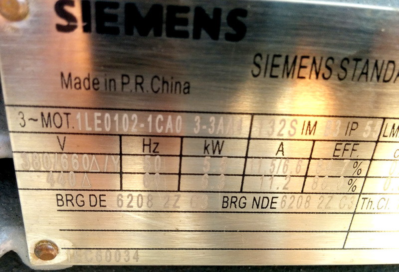

Howdy Azza,
Is the motor inverter-duty rated, most motors theses days are rated as such. If not, you should consider installing a dV/dt filter on the drive output.
I see no reason why you could not start-stop the pump as often as required to suit demand.
I don't see the ON-pressure setting being an issue, but rather I see the OFF-pressure setting being more of an issue. I would suggest that for starters, that ON-pressure limit < 75% of nominal would be OK. The real trick will be to select an OFF-pressure limit. ie Don't forget that the VFD will try to keep the pressure close to the normal setpoint, and the only way to ensure that the system can hit the OFF-pressure limit is to ensure that the VFD minimum speed is high enough to ensure a high pressure can be obtained during low-flow or no-flow conditions. This can be a bit tricky to set up. Having a Flow-transmitter helps a lot ( ie you can simply stop the pump on no-flow ).

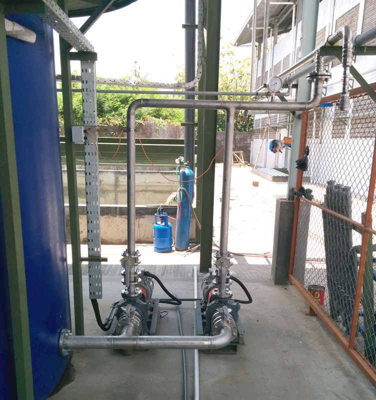

GG, itsmoked, thank you for your valuable advice! Here is a picture of the pumps, as promised. (Should have used a tank outlet isolation valve, but alas. Will add next time I take the piping apart)
The bit about stopping the pump ... I must admit I did not think of that. Somehow I assumed that even with PID control there would be some degree of a spike when all outlets are closed, but before the controller corrects. With this new info in mind, I am quite open to the flow sensor. Now, all I gotta do is source them...hahaha.
I looked into the dV/dt filters. They are quite beefy, aren't they? The ones from the maker of my drive (Toshiba) are about the same size as the inverter itself and weigh... get ready... 30 kg (65 lbs)! Does this sound about right? Where would you mount this thing? Not in the cabinet, right? Also, my cables are < 50m (150 ft), is it still justified?
Not sure if my motors are inverter rated, probably not, unless it comes standard somehow. The fan certainly runs slower if the frequency is down. I've attached the nameplate, if there's an easy way to tell.
About the bladder tank, how big would it have to be for a 15 m3/h (65 gpm) flow?

Hi Azza;
See the following link for Gould's bladder tanks;
http://goulds.com/tanks/
WRT size I would spec their largest standard size of 115usg.

I would contact your pump/motor OEM and ask if the motors are VFD rated. I'd be surprised if it wasn't so rated. If the motors are in fact VFD rated, that together with your short motor feeder length (of 50m), I would recommend that a filter is not required. However, if the motors are not rated for VFD duty, I would recommend that the filters be installed.

Hi Azza; Groovy's got some nice links there and I pretty much agree with his filter suggestions.
I don't know if those motors are VFD rated. One thing that can confuse you is if you ask a maker, "Is this VFD rated?" they will almost always tell you NO you need to pay 2X the normal price for that. Their fall-back argument is always that if there isn't an auxiliary motor running the fan then how could it be VFD rated? In pumps you never need that aux fan since the motor is going to have to spin at least 50% of the rated speed to make a centrifugal pump do anything and when it is running at 50% the load is more than covered by the existing shaft mounted fan.

The VFD frequency is set and forget, not varied.
Engineers love to gild the lily but:
The tried and true KISS solution is to use a bladder tank, a DOL pump and a pressure switch.
Bill
"Why not the best?"
Jimmy Carter
amazing azza; !!!! I somehow missed your 11 DEC post and just saw it now.
I'm very pleased it worked well for you. Hope your system is getting hands off for you finally.
Yo Bill! I think I see an issue with your scheme:
Quote:
Set a pressure switch to stop the pump when the pressure rises to 40 PSIG
Use a pressure transmitter to control the pump at 30 PSIG when it is running.
With fed-back control to 30 PSIG why would the system EVER achieve 40 PSIG to shut-off?
Keith Cress
You would limit the lower frequency of the VFD.
Quote (Bill)
Maximum pressure when pump is running at minimum speed = 45 PSIG
I see the VFD solution as a good way to supply a needed pressure and/or volume boost to an under performing system.
I would use the VFD system as a supplementary system, never as the primary system.
(Large municipal systems may be excepted.)
That said, congratulations on a successful solution. lps
