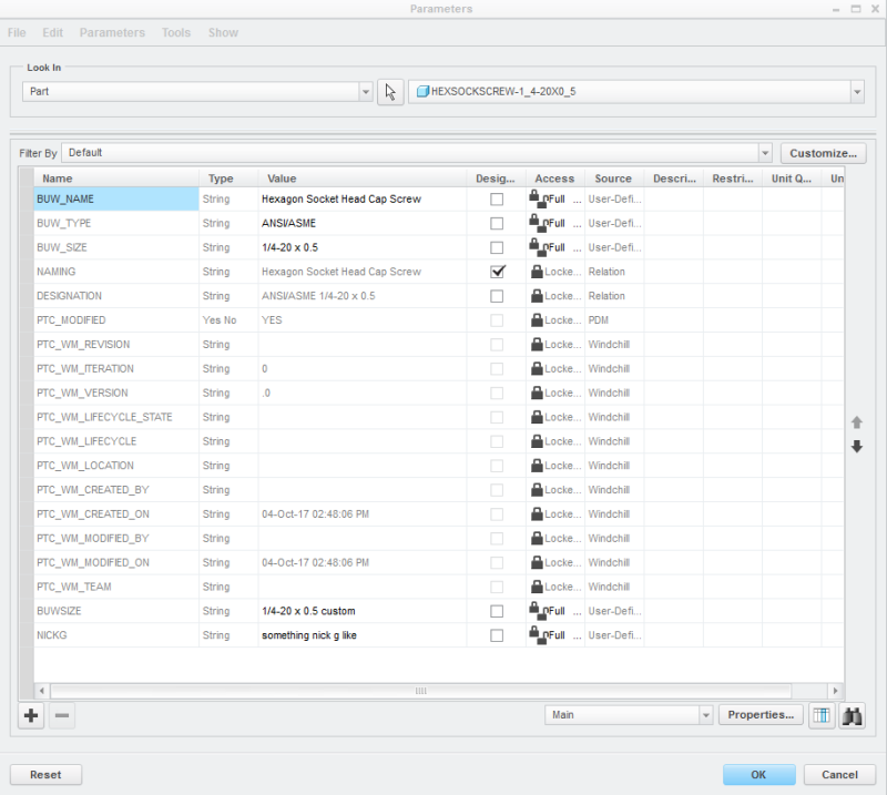

We use a hardware library in Windchill with Creo 3. It works, but I started playing with the Intelligent Fastener tool and really like it. It's much faster/easier than using hardware libraries.
Therefore, I'm trying to get our BOM to work with it.
Here's my stupid part:
And here's my current BOM:
With the current relations:
Here are the screw parameters:
So I wrote this relation in an attempt to select either the screw parameters (naming, designation) for item and description or our standard model parameters (drawing_num, description), and then to tie that to the repeat region using the new parameters (item_name, item_description). The new repeat region parameters are (asm.mbr.item_name, asm.mbr.item_description). Ignore the first block, that's to list bulk items with an "AR" for quantity.
But I get an empty BOM with this relation. Using "naming" and "designation" for my repeat regions, I can get the screws to show up, but not my created hardware:
So. Any idea what I'm doing wrong? I've spent several hours trying different combinations but can't seem to get it to work.

1) There is no upper conversion routine. You would need to extract the ascii value of each letter then determine if it is upper or lower and if lower, rewrite the string with the upper value. I used a subroutine for this when I did GRIP programming in UG/NX.
2) Use asm.mbr.item_name and asm.mbr.item_description as your repeat region fields. You did the asm.mbr for the original parameters then switched.

Thanks for the help Ben. Since I've posted this, I've revised the code and corrected the error you mentioned. However, I still can't get this to work.
To simplify, I'll show only the one section (description). Currently I have the following code written:
if exists("ASM_MBR_DESCRIPTION")
item_description=asm_mbr_description
else
item_description=asm_mbr_designation
endif
So now the table will show the description for my created parts, but is blank for the screw file. I've tried several of the parameters listed, as well as making my own parameters (BUWSIZE and NICKG). I can't get anything other than "asm_mbr_name" to display in my table. Here is the parameters shown on the hardware:
I appreciate the help you've given. Hoepfully it's something simple I"m overlooking.
