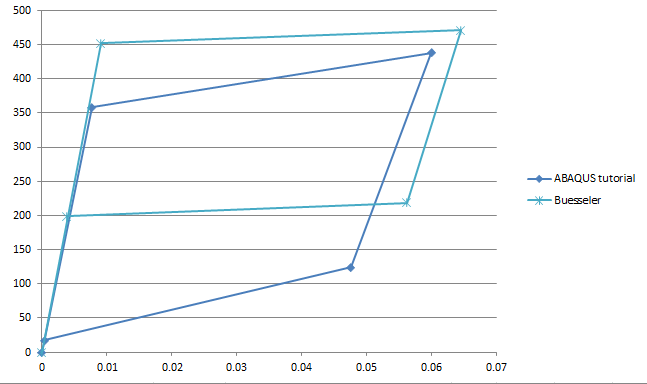

I'm having some difficulty running a stent analysis and I'm hoping there might be some expertise here that can help me out. I just got done taking the online stent simulation tutorial from Simulia, and now I'm working to extrapolate on my own practice. I have a very simple laser-cut style 8- strut, single loope strut "stent" in 1/8 symmetry. It's nitinol, with an expand, recoil, and pressure steps. It fails about 0.73 through the expand step with time increments too small error. (general static step). I'm trying to define the nitinol with plasticity so I can overstrain it and model a good recoil behavior. My material model is as follows:

I've also tried eliminating the plasticity part and it still fails around the same time step. The max stress is only around 70 ksi, so it's still well within the material model. I've done "tricks" with nlgeom, and general solution controls I0, and Ir. I attached my cae file here.
Any thoughts why this won't converge?

Contact initiates almost immediately in the expand step. It quickly expands about 50% through the step, then bogs down. I ran the same model with the material model from ABAQUS, and it did complete, but with stress values an order of magnitude higher than what is possible. Just for completeness sake, here's the ABAQUS material model:

I'm hesitant to condemn my material model, because the two are so very close:
But on the other hand that one seemingly simple change really messes things up. Perhaps it's highlighting an issue somewhere else?
I'm running it right now with a linear elastic only "steel" model (no plastic definition at all), and I'll see if it completes.

So a quick update: I ran some jobs this weekend. The ABAQUS material model does complete, but the stress values are 4,300 Mpa - obviously way too high. The material model that I developed above doesn't get much beyond 2% strain before it fails - it doesn't make sense.
RE: ABAQUS stent analysis failing
I took a look at your model and I you have two problems.
Firstly, you're using inconsistent units. Your dimensions appear to be in meters but your stresses are in PSI. For consistency the stresses should be in Pa. Alternatively, scale your parts so they are in mm and adjust your stresses so they are in MPa - I find this much easier when modelling stents. Secondly, your transformation and volumetric transformation strains are different values. When this is the case, a different flow algorithm is used and the USYMM parameter is required on the *USER MATERIAL keyword. If you try to run the analysis without this parameter included you will run into convergence problems. Your model produced non-physical results with the Abaqus material model due to inconsistent units (dimensions are in meters but stresses are in MPa). Also, you did not have convergence problems with the Abaqus material model because the transformation and volumetric transformation strains are equal values.

I've been mixing/matching so many different attempts I must have mixed my units along the way and didn't realize it! I had attempted several different models, and used several different online resources to provide information. I feel like a dunce - complete rookie mistake.
Thanks also for the catch on the volumetric strain - you described exactly what I was running into. I'll go through and double check all my units, make the edit to the material model and try again. Thanks for bearing with me Dave!
