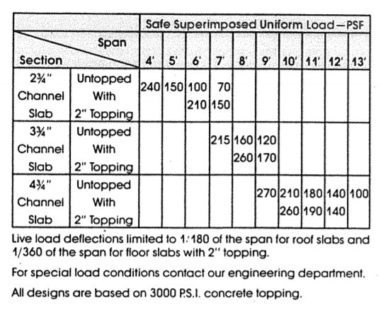

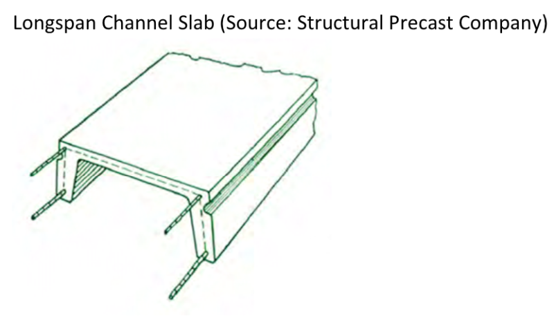

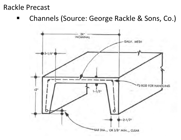

Do any of the following three systems look similar to what you have?
The MidCon channel slabs were commonly supported on steel beams. Here is a load table for their products - not sure of date of publication:
