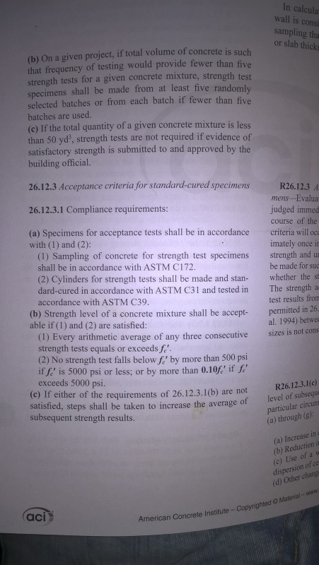

The results of the 28-day tests aren't meeting the target compressive strength. We believe it's due to the strength retarding properties of fly ash in the mix. Assuming the 56-day test meets the target; are there any implications to long-term durability (40 year service life) with utilizing concrete that met it's target strength late? The foundation won't be loaded until the target strength is met.

Thanks everyone. The target strength is 5800psi; the 28day strength averaged at 93% of that. Surprisingly core samples taken a few days after the 28-day strength are coming up as low as 3790 which is 65% of target strength. Because of this we believe there is a large difference in the mix at the top of the foundation vs. the bottom of the 4'9" thick foundation. The 28 and 56 days samples are taken before any concrete is poured (to check for air in the mix) while the cores are taken at the end of the placement.

ACI defines acceptance criteria (ACI 14): 26.12.3.1
Looks like you are not meeting these requirements.
