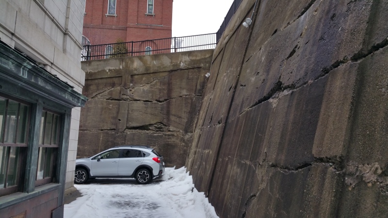

10" down to 1/2"? From what you described I'd suspect carbonation of the concrete causing a loss of passivization of the reinforcement and the subsequent rust jacking and freeze-thaw action spalling the concrete to be the most detrimental effect. That said, I've seen some pretty poor mass concrete last over 110 years; albeit with major spalling and failure of the cement (exposed to deicing salts and heavy freeze-thaw cycles).
Eventually the cement paste breaks down due to acids and other environmental wear and tear, and that's hard to prevent.

1) At least another 50 years and probably a lot more if you can suffer heavy spalling.
2) I'm sure I can dig up something. My first stop would be the concrete repair manual and see where that led me.
