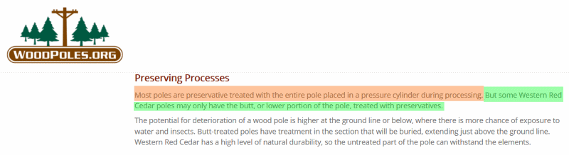

In North America, utility poles are covered by the North American Wood Pole Council (NAWPC). Preservatives, such as creosote or CCA, are not applied the same way as structural lumber. The preservative is forced in, under pressure (same as structural lumber), but then "drawn" back out (with vacuum). Because of this lower treatment requirement, utility poles are more subject to in-ground "rot". This is partially compensated for, as dik mentioned, by using high quality trees, when new.

Another thing about creosote treatment. Usually it only is done for the part buried. So likely use of them as buried supports would not be a good idea unless you know tht part to be buried also was in use that way.

I've seen plenty of what I assumed to be creosote on the above-ground portion of poles. I just assumed they treated them top to bottom.
A friend said her husband came up with a bunch of old telephone poles like that, and he sold them off to area farmers/ranchers for fencing purposes.

For information about the species and preservative treatment on utility poles, look for a metal tag or brand on the pole. See http://www.bki.cc/blog/15
