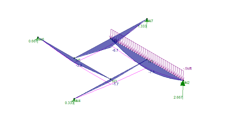

For what it's worth, I just created a quick RISA 3D model and it seems to work just fine.
Not saying I'd ever try to build this but I believe it does work.
The tough part for me to reconcile is "chasing" the load around the ring. In my first model (with only one distributed load) half the reaction gets passed to the connected beam over and over and over until it effectively is zero.

I was skeptical, but I built the same kind of model as DETstru and it worked. The deflection really wasn't that large either. I was very careful to make sure that I didn't have any weird torsional interaction between members. And, that's not including any kind of system non-linearity. So, it appears that it is a stable system... Though a very, very weird one.

Huh. Sounds as though I was incorrect about linear methods not working for this. Which leads me to my next point of interest.
If we drop the pretense of "instantaneous load response", as they discuss in that article of slick's, it seems to me that the question should not be "why is load chased in this situation?" but, rather, "surely load is chased in every situation?".
It has long been my intuition that moment distribution is not just an expedient calculation method but, instead, a true description of how load response flows through an indeterminate structure. The handling of imbalances in moment distribution strikes me as too similar to "load chasing" here to be mere coincidence.
Even in an ostensibly determinate structure such as a simple span beam, I feel that you'd still get this "load chasing" at the atomic level as individual molecules rearrange themselves to produce load resistance (equilibrium) while continuing to obey their own version of material law (atomic repulsion and attraction). Every simple span beam is really a gazoolion interdependent, molecular springs after all.

DETstru, what happens if you have axial springs on the supports? The supporting beams are obviously not relatively stiff in their weak axis flexure and I feel this will change how your beams react.

Good point. To heck with axial springs though, let's go axial wheels. Should still be stable externally.
RE: Modern Steel Construction Steel Quiz
Switching to springs made no difference at all. There are no horizontal reactions, only vertical.

I ran a RAM elements analysis and it didn't show any problems and didn't show any axial forces or weak axis bending. Really, it only convinced me that RAM isn't a proper tool for this type of problem.

I'm trying to mentally calculate the reactions if only one of the beams was loaded and it's kind of driving me crazy...
Quote (atrizzy)
This was actually why I made my little chopstick model. It's actually fairly simple once you think about it but it does have "second-order" effects. Each beam acts simple span and thus a load on beam #1 causes a reaction of some percentage onto beam #2, that loads some percentage onto beam #3, then that loads back beam #1. Thus, you need to run multiple iterations to get the true load but the actual math is just simple span beams.

Doing the iteration by hand, you find that you come to 99% of the reaction after the second iteration.
With one beam uniformly loaded in a system of four beams connected at their midpoint (like the DETstru model, I think) each reaction around the perimeter is half the adjacent reaction. (Look at the reactions in the first DETstru model above)
So, you'd expect the reaction to be 0.5*W in a simply supported beam. In this* reciprocal system, the reaction at the loaded beam is 0.533*W = 1/2W + 1/32W + 1/512W + ...
*edit: the summation applies to this geometry

In the model below, I've intentionally stripped the boundary conditions down to as few as I believe can be had while keeping the thing stable.

Beams have been numbered B1 through B4 in the attached sketch. As noted, the only applied load is W on B1 which is assumed to occur at 0.75L from the left end where L is the beam length. The external reactions are labeled R1, R2, R3 and R4 which apply to B1 through B4 respectively. The reaction of B1 to B2 is assumed to be P which is to be determined by statics.
Beams B2, B3, and B4 have a beam reaction applied at midspan from B1, B2 and B3 respectively. Consequently, their reaction at each end is half of that load.
All beams are simple spans, so the calculation is relatively simple.
It was found that for load W at the location shown:
R1 = 0.3W
R2 = 0.4W
R3 = 0.2W
R4 = 0.1W
R1 + R2 +R3 +R4 = W as expected.
If all four beams have a load W acting at 0.75L from the external end, the principle of superposition can be used to find that each external reaction is equal to W.
BA

So I decided to do my own modelling. The RISA file is attached for anyone who would like to critique it.
- At run time, I get a program complaint of "Z reactions do not sum to match Z loads". I'd be curious to know if anyone can resolve that as, to some degree, it casts a bit of doubt on the solutions.
- Presumably, because of the runtime error just mentioned, I'm unable to report joint reactions. They can be gotten indirectly via shear diagrams.
- I believe that this test supports the hypothesis that these are statically determinate systems. The response parameters, such as the moments shown below, do shift slightly from one model to the next. However, that's a very slight shift over what is about a 100 fold increase in vertical displacement.

Yes! This shows algebraically what I did numerically with the same geometry. I determined the first reaction to be 0.533W but really it's 8W/15, which is an important distinction in this thread. ;) Either way, the reactions are determined without regard to the member properties.

I missed the discussion, but jumping back to the matter of determinancy.
The practical definition of determinancy make it pretty obvious (in additional to the mathematical definition that Cal pointed out):
Removal of any degree of freedom from the supports will result in failure.
Addition of a hinge or roller or other release within a member will result in failure
There is no redundancy, therefore it is statically determinant.
