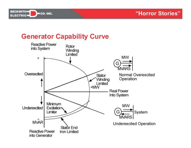

well, so if I will run the generator as a condenser, it will be overexcited supplying vars to grid (working as a capacitor), but, if the generator is supplying a capacitive load, it will be absorbing power, must be underexicted then.
the photo here says it all.

The effect is that it has to operate at a different power output to not overheat the rotor (for putting vars into the system) or the stator (for absorbing vars). How much of a difference this makes depends on the MVAR vs MW curves of the generator. Some generator owners complain about needing to support the system voltage at the expense of MW generation. So, some ISOs have items in place to compensate generator owners for supplying vars.
For stability, generators are locked my tightly to the system when they are supply vars, which means they are generating at a high voltage.

There is a lower limit to the leading vars a generator can absorb. Have a look at capability charts. A while ago I uploaded a superb reference paper on the co9nstruciton of capability digrams which was pubslihed many years ago by the CEGB.
