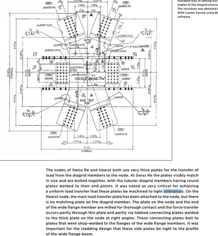

I suspect that it would be best to discuss this with a fabricator given how specialized the application is. I have Terri Boake's book on diagrids. It doesn't get too deep into tolerances but I've included all mentions below in case any are helpful to you. I suspect that your dome would be less demanding than a lot of these examples.
