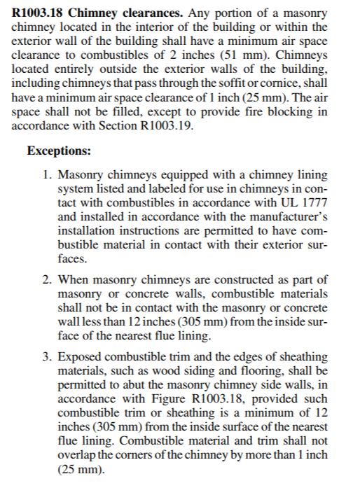

I am designing a residence and I would like to use the chimney as part of my lateral force resisting system. Does anyone have details showing a typical diaphragm-masonry chimney connection and a collector-masonry chimney connection? Based on my review of the IRC, a minimum clearance is required to prevent damage to wood members (which makes sense), but I am confused on how designers maintain this clearance and provide an adequate load path. I apologize if this is a simple question but I had some difficulty finding resources on line that discussed chimney detailing as a member of the lateral force resisting system.

I believe that we generally try to isolate our chimneys from the adjacent structure when possible. See this thread for additional info. Creating hard attachments to something that gets hot and experiences significant temperature fluctuations can be tricky.

Depends on the liners etc. Most of what I think I know about acceptable chimney construction comes from IRC. I don't dispute what has been done in the past. Often the situation is reversed and you're needing to tie the chimney to the diaphragms for seismic support. Lateral expansion is not my concern as the dimensions in play are small relative to thermal COE. Vertical might concern me in a taller building I suppose.
I'd think that you'd need to satisfy exception #1 below in order to make a go of this. Connecting with steel hardware across any gap might make some sense rationally but I'm unsure how well that would be received by AHJ. Metal being a rather good conductor after all.
