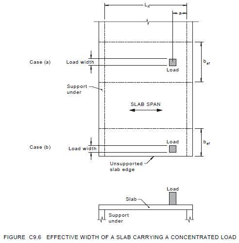

RE: Vehicular Load: 3,000 lbs acting on an area of 4.5 in. by 4.5 in. Distribution Factor?
Found these in an ET thread a long time ago but I don't know what thread.
DETstru-
I believe those provisions are from BS8110 (or at least, that code uses the same formula).
Personally, I've only ever used the wheel load to check localized shear failure, and otherwise used the 40 psf garage load. But if your span is short enough, the 3k load would control for flexure as well.
Brian C Potter, PE
Simple Supports - Back at it again with the engineering blog.
This is the thread, which contains some info about the equation's assumptions:
http://www.eng-tips.com/viewthread.cfm?qid=394262
For load at the center, you can take b = 0.6 * L.
The method shown above is BS8110 and AS3600 also. I have tended to use half of the value from that method for suspended slabs. I have never been willing to accept that on a 10m span, I can assume 6m width will carry the point load applied at centre span.
