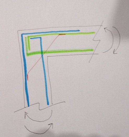

I have studied some moment RC joints. I m reinforcing concrete moment frame (3D). My problem is that beams and columns are both 300/300 mm (small dimensions when rebars from column, beam and another beam perpendicular to other beam comes/meets together). Since im dealing with a moment frame (earthquake) every column - beam joint is an opening and also closing joints (it depends on direction of lateral forces).
Without red diagonal rebar the joint doesnt work when it comes to opening moment right?
is there any other options on how to reinforce this without diagonal rebar by using rebars from beam/column?
(there are just too many rebaras in small joints already)
RE: RC moment joint
You typically only see the diagonal bar with water retaining structures. In those cases, such detailing minimizes undesirable gaps and is more efficient as far as reinforcement goes. (It can also deal with shear across the joint.)
Usually congestion isn't an issue with it as long as there is proper detailing.

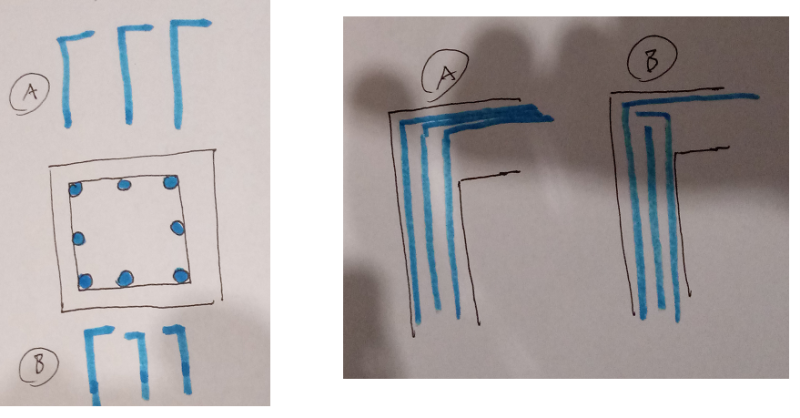

Another thing im asking is would you bend all rebars from column in to upper side of beam (A)or just the outer bars (B)?
since I have so many rebars in column i dont know what to do with all of them.
Another issue is that i have beams connecting to a column from 2 direction. So what is the best case with bending columns rebars in case of so many bars?
RE: RC moment joint
Typically you wind up running the beam reinforcing into the column....not the other way around. Usually it's less re-bar in the beam so that cuts down on the congestion.

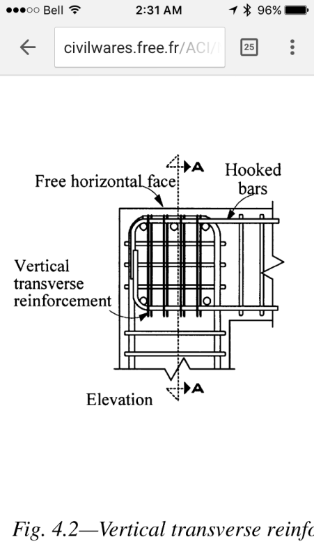

This is what ACI recommends for these joints. No diagonals, standard hooks turned into the joint, and hairpins from the top. It's a good blend of performance and constructability.

Kootk TNX for this detail. However I havent decided yet what to do with my rebars in column since I have 8 of them. In a picture you posted there is some kind of hook at the top but since I have beams from 2 directions (one perpendicular to other) it gets confusing. I cant believe I havent found a single good photo of this example on internet yet.

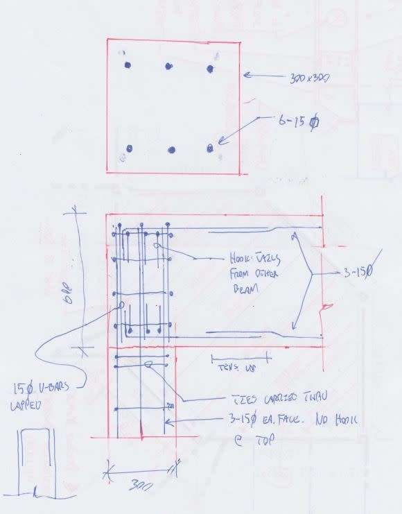

Your criteria:
- 300 x 300 column
- Column width = beam width.
- Strong beam : weak column.
Seems to me the answer is to use deeper beams so that bar layering can be accommodated without significantly compromising strength. I feel that the detail below would be fairly contructable and more or less consistent with conventional detailing practice.
