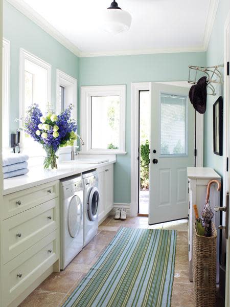

Mud Room. In rural areas the first room on entry. This is where you take off and store your muddy boots and outdoor clothes. This room often does double duty as a laundry room.

That mud room is cleaner than my kitchen!
