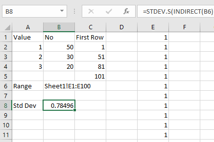

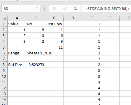

A non-VBA solution is:
Set up a table of the number of each value (Col B) and the first row for each value (Col C), then in E1 enter:
=MATCH(ROW(D1),$C$2:$C$5,1)
and copy down as far as required.
Then generate the address for the list of values required: ="Sheet1!E1:E"&C5-1
You can then use Indirect to return the standard deviation on that range:=STDEV.S(INDIRECT(B6))
Then enter the number of 1,2 and 3 in column B and the Standard deviation will update:
An alternative would be to do it in JavaScript, which could presumably be converted to G-sheets pretty easily, or use Excel on One-drive, but I have yet to try that.
Or my preference would be to use a VBA UDF, and forget about G-sheets :)
