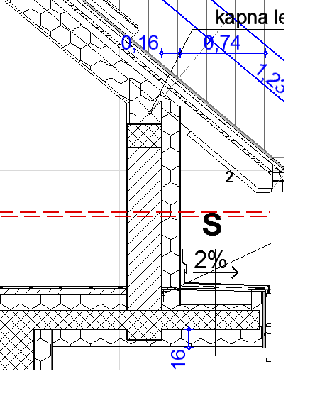

Im wondering how is load stransfered here.
RC beam is partly integrated into RC slab. There is a bearing masonry wall on top of RC beam (over entire lenght of the beam). Since beam is almost 6 m in span, but distance from slab to wall is only 0,80 m, does that mean that load gets transfered through slab too since distance from beam to wall is short and loads always took the shortest path?
Im asking this because I get so much different results when calculating this as 2d problem in FEM software comparing to hand calculation where I only consider beam and a load on it.

There are multiple load paths, which is good. So the structure will resist the loads as it wants, regardless of what you assume.
Not sure of the construction of the bearing wall above, but the first and probably predominant load path would be the wall/beam transferring the load directly to the columns as a deep beam.

Wall above RC beam is 1,40 m high masonry wall that supports rafters. So are you saying that masonry wall above beam + RC beam can act as deep beam (compression in masonry and tension in RC beam)?
RE: How is load transfered?
Possibly, if the masonry wall is strong and stable enough. It will try to span in that fashion. Follow the stiffness.

OK. If you don't like using the reinforced masonry as a deep beam, just design the concrete beam to carry the whole load. The slab doesn't help, as it has no support on one end.
I think that most designers would put the full load to the beam and consider the wall's ability to span a nice bonus. Depending on construction, the beam may need to support the wall while it is constructed and cured anyhow.
I would definitely design the beam to support the load from the wall as well as the adjacent slabs in 1-way action. Take the additional load paths as an added bonus.
Your point about the wall taking load under FEM has merit too, of course. It'll happen. I'd include a light mesh of bottom reinforcing in the slab for crack control in acknowledgement of that.

Of course the slab need reinforcement also at the top because it is cantilever with bending tension on the top side

Load doesn't take the shortest path, it distributes to more flexible paths. That beam is 7.5 times as long as the distance to the wall. If the connection at the wall is fixed (stiff/thick wall, top reinforcing), it's like your beam is spanning 6m but the slab is spanning 1.6m simple span (0.8x2). Your slab is like a 6m wide, 1.6m long simple span beam. it can most likely theoretically support itself depending on load and thickness. My guess is that a very large portion of the load will go straight to the wall. I have access to RISA floor, and a very quick model would give me all the bending moments and deflections as a 2 way slab. You could consider it this way, or design the beam for the full load knowing that you feel comfortable with a D/C of 0.999. Most times I would probably just design for the beam cuz I can do that in a minute with a mental calc. If it's a one-off situation, adding a few pounds of rebar won't cost too much.

Quote (AaronMcD)
Actually load distributes to paths with greater stiffness.
Quote (AaronMcD)
Very likely not the case. There is no reason for trying to develop the top bars. It's hard (and pointless) to make that connection anything more than a hinge.
Quote (AaronMcD)
No, the slab cantilevers past the beam as can be seen in the plan and section.

As depicted, the slab is not a simple span, it is a propped cantilever.

Yes, if it is considered a hinge of course the load won't go there. I don't have all the details, just considering what OP said about load going to the wall, which would happen. Top bars will likely be hooked and developed. Depends on bar size, wall thickness.
Hokie66 & DETstru, Yes I see the slab cantilevers, but a cantilever is half a simple span, the easiest way to estimate if a cantilever will work. It depends on how stiff the wall and wall connection are.
Re-looking at the details, both the wall and the slab seem to be discontinuous at the intersection, so it may be quite flexible. In that case i would probably just ignore the wall as support, though theoretically it may take a good portion of the load.

There is no point in trying to develop a truly fixed connection from slab to wall. It's difficult to do regardless of whether or not you hook the top bars.
The only load that will go to the wall is from when the beam deflects. It's flange (the slab) will push down on the wall and that deformation creates the load. That might be completely countered by the rotation induced by the cantilever on the opposite side of the beam. This can be determined in an FEM analysis but there is no point to doing one.
It would not be wise to rely on that slab for supporting the wall whatsoever. Just provide some extra bar/mesh in the slab in case of cracking if one really wants to.

I think you have misinterpreted my comments about load taken by the wall. I was talking about the wall above, the one on top of the beam, spanning between the columns. If that wall is reinforced appropriately, it would act as a deep beam.

Well, since we are now discarding any cantilever action, which is definitely the easiest way to analyze the problem at hand, nothing apparently.
But in general, that's one of the first things I notice when designing cantilevers for strength. Backspan/connection may have some flexibility which is important for deflection and in this case to determine load path, but an ideal (fixed end) cantilever is just half of a simple span (inverted of course). So if I have typical simple span sizes, loads, and spans on a project, I know the same size member can cantilever half the distance for strength.
Hokie66, yeah I understood what you meant. The OP was considering the concrete wall. I agree with you that the wall above may take some load. I would not design it as such, but considering it will be in compression (assuming the dowels act in shear) my guess is that it will provide significant strength and stiffness.

Ideal, fixed end, cantilevers are rare in concrete structures due to the difficulty of chasing the stress around the corner. Even when detailing and construction are carefully done, efficiency of these corners does not approach 100%.
