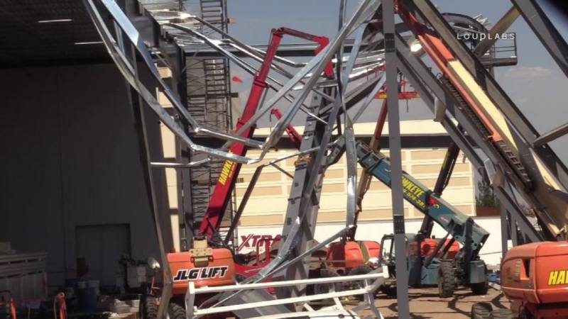

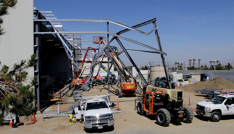

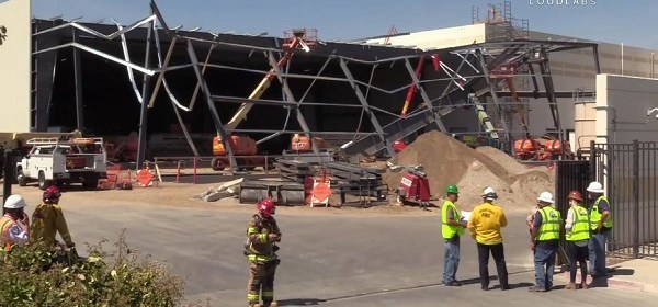

I found a building in Riverside, CA that one or more frames collapsed while the rest of the building appears to be fine. All my information comes from a few pictures found by a web search so I don't know any more details. If anybody has any more information like the width of this building or the manufacturer I would appreciate whatever you can find out.

Collapse date: May 3, 2017.
Location: Riverside, CA west of I-215 on Meridian Parkway
I did a quick check of CalOSHA and did not see any citations (that often describe the building type/spans/configuration in detail) but such investigations usually take some time.

Assuming my post above is the project your refer, here is some additional info:
Building Owner: JBS USA FOOD, Inc - they produces 'case-ready' meat, pork, poultry etc.
Facility: Existing was 110,000 SF. 2017 expansion was 60,000 SF.
General Contractor: LEDCOR Group for 2017 expansion.

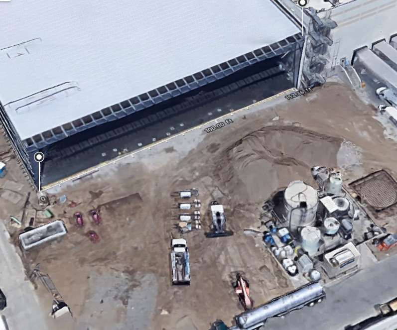

Based upon some photos of the collapse, I figure some 'rough' estimates that the expansion was 1 new interior frame (welded plate girder) and 1 end frame (with wind columns). Frame spacing may be 30-35 ft (?). Orthogonally, about 6 or 7 bays of 25+ foot spans, so that makes a width of somewhere around 150 ft.
No info on who the PEMB manufacturer was.
Here is a Google Earth 3D view of the site from 2017 during foundation works. Scaling, the plate girder span is 152 ft.

Possible inadequate lateral bracing during erection, but we'll see. The crane could have created some instability too.
Mike McCann, PE, SE (WA)
RE: Pre-engineered Metal Building Collapse in California
We recently had some high winds come thru the area. Could be inadequate or missing bracing.
I see a lot of channel sections buckling. Channel sections should not be used as beams when not symmetrical about the vertical section. They have no load rating as such.
Channel shaped sections are used all the time as beams. Especially in pre-engineered metal buildings. Typically in that case they are called Girts or Purlins.
