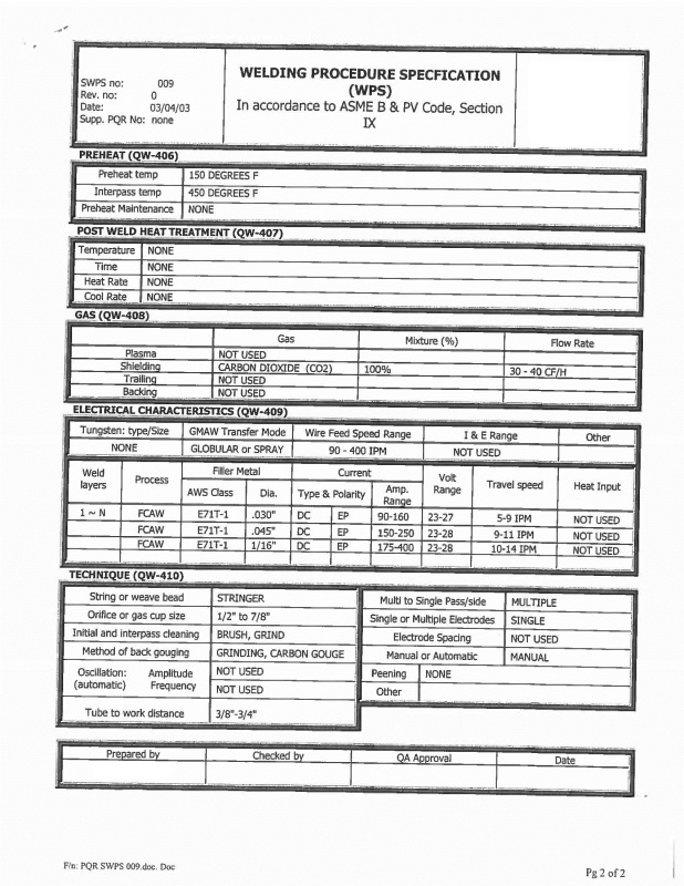

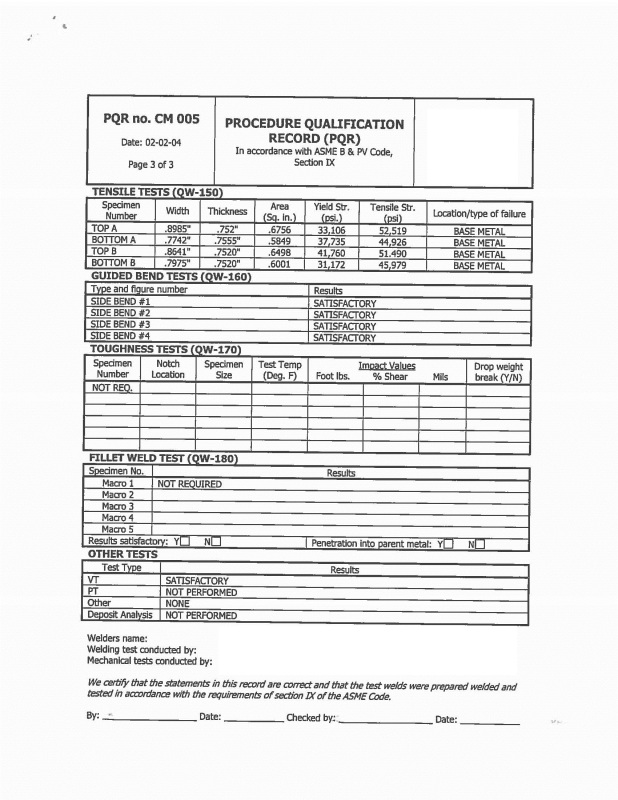

I was provided with a WPS and a PQR. I was looking them over and found a couple differences and would like a second opinion on it.
Page 1 of the WPS and page one of the PQR, under QW-402, does it matter that the thickness is different, the root spacing is also different?
On WPS page 1 still, under QW-405 it says all under positions, but on the PQR under position it says VERTICAL 3G, that is wrong?
If you find any other mistake, difference or discrepancy please let me know.
thanks in advance for all your help.

Position is an essential variable only for the welder, it has no bearing on the procedure.
RE: WPS AND PQR
Position is not an essential variable.
RE: WPS AND PQR
There are concerns with this WPS....none of which you have brought up.
WPS states base metal qualified 3/16" - unlimited. How is it unlimited?
Shielding gas used for PQR was 75/25, but WPS states 100% CO2.

One final comment....SA-36 Min UTS= 58000. .95*58000= 55100. All tensile tests failed.Startover
RE: WPS AND PQR
Also no certifying signature on PQR. Was this document actually submitted by a Manufacturer? I assume that the Manufacturer's name was deleted by the OP. I haven't reviewed a WPS/PQR as poor as this one since the mid 1970's, although a few came close after 2010. It appears that history is repeating itself once again.

Shippawa,
I am getting soft in my old age so I will offer you some advice.
The reason we have welding procedures is to ensure "sound weld repeatability".
In plain English that means we provide the welders with minimum and maximum parameters on the WPS so if they stay within those parameters there is a good chance you will get a sound weld over and over again.
The WPS you have provided is a joke and either your contractor doesn't have a clue or they think you (the client) don't.
Giving a WPS to a welder that lists multiple wire diameters, multiple positions and multiple thicknesses is a recipe for disaster.
"Guys, just weld however you want, we have every possibility covered in our one page special WPS" ?????
I have had a brief review and here are some of the major concerns you need to look at:
1 Preheat
2 Material Thickness ( noted by David)
3 Weld Deposit thickness
4 Wire Feed Speed
5 Gas composition (noted by David)
6 Amps / Volts / Travel Speed
7 Tensile results (noted by A.Clark)
8 GMAW Transfer mode ?
9 PQR not listed on WPS ?
