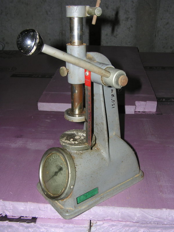

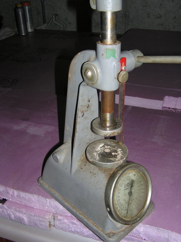

For relatively little extra time required consider upgrading a little. Assuming that disturbance effects are not still significant, a quick unconfined compression test on what would appear to be the least disturbed part of the SPT sample, run a Qu test taking maybe 20 seconds. Try for a sample height at about twice the diameter. A Remac valve spring tester will do the job and gives max pounds developed. I no longer am that active, but I had a chart on hand for differing diameter samples and had a significant range of input of pounds in one column with Qu next column, to simply be filled in on the log. Sure it may not be ASTM, but is a heck of a lot better at getting a usable number than a penetrometer. This one is a little dusty from sitting in my basement.
Here is from eBay.
http://www.ebay.com/itm/like/111555761381?vectorid...
This one is closer to the old model I have.
http://www.gaugesandgadgets.com/rimac-valve-spring...

Nice pics OG...I am just trying to imagine how many other interesting field tools may you have in that basement...
