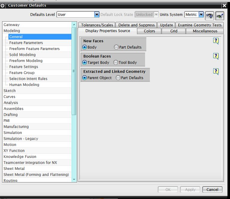

RE: Can't WAVE linking sketch curves that are reference.
For now what I found is shown in the above picture.
If the setting is parent object then the curve style is like the parent
object style and if the setting is part defaults then the curve style
is like the part curve default style.
I'll keep explore and see what's there.
Thanks.
