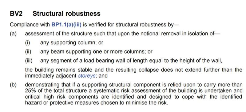

Hi hetgen,
This is what the Australian Building Code calls for. It sounds that you are not from Australia but this might be a good starting point.

@ ajos6183 Thank you.
Does the Australian code give guidance on how to conduct a systematic risk assessment for critical components?
The transfer beam doesn't carry 25% of the total structure weight, but it is certainly a critical component.

RE: Redundancy for transfer beam supporting mid-rise tower column
To the best of my knowledge, the Australian code does not give any guidance on how to conduct a systematic risk assessment.
