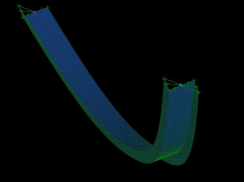

I have been having difficulties working out axial buckling about non-principal axes. I have come up with an example to illustrate my question (please see attached).
Suppose we have a simply supported column under compression only with a midpoint restraint about a non-principal axis. I am interested in finding the first buckling mode in the unrestrained non-principle axis of this column and after that the effective lengths about the principal axis.
Part 1: Finding Pcr
My initial thought was that i can use Pcr = pi2 * E * In / L2 where In is the second moment of inertia about the non-principal axis.
For example, suppose that Ix = 42,082,500 mm4 and Iy = 7,382,500 mm4 and the section is rotated 45 degrees, then In = Ix - 0.5 * (Ix - Iy) * (1 - cos(2*45)) = 24,732,500 mm4. I have confirmed this with a simple FE model in Strand7. (Note that subscripts x and y refer to the principle axes whereas n and p refer to the non-principle axes at 45 degrees)
However, this paper seems to say that i cannot do this in the case of a discrete restraint (my situation) and suggests instead an effective or quasi moment of inertia approach. Any thoughts on this?
Part 2: Finding effective lengths about the principal axes
In this case, i know that Leff,n is the full length of the column and that Leff,p is half the full length. However, i am not sure how to convert these non-principal axes effective lengths to principle axes effective lengths (Leff,x and Leff,y) to be used in design. I look forward to your thoughts and help on this.
Thanks,
Anthony

gravityandinertia and WARose - if you look at my attachment, you will see that i have a restraint mid length of the column that is 45 degrees to the principle axes. Therefore, it is not possible for the first mode to be a pure principal axes buckle.

Strand7 showed a buckle about the geometric axis, however, i was still a bit concerned given what the AISC article talked about.
RE: Axial Buckling about Non-Principal Axes
Should buckle about the non-principal axis - my own quick little Strand7 model confirms this and the buckling loads using In check out. Quick scan of the paper - looks like the effective moment of area is only relevant for non-doubly-symmetric sections- if Ixy = 0, Ieff = Iy.

Thanks KootK, at step 3, the moment about the X-axis creates moments about both the major and minor principal axes. But does it create a moment about an orthogonal geometric axis? I wouldn't have thought that it will do that.
I am finding that i cannot pick it up in a linear buckling analysis.
I performed a linear buckling analysis on the Z section example that is shown in the AISC paper but i still got the lowest buckling mode to be at about 26 kips in the X-Z plane, instead of the reported 13 kips!
Based on the sketches you've posted before, it appears that you're using eight elements to represent the member? If so, that's only four per half span which may not be sufficient to capture the second mode influence.
It might also be worth investigating whether or not the elements that you're using to model the member are even capable of "seeing" the coupling between the two geometric axis moments. I would expect that to require discretization not just along the length of the member but, also, within the cross section itself. I don't know Strand7 from Adam though so take my comment with a grain of salt.

I tried subdividing further just now and there is no change to my previous result. I also used 'Mastan2' to double check the results from 'Strand7' and they are identical. Any chance this could be a second order effect that is not captured in a linear buckling analysis? (although it doesn't look like it is)

I just did a 2,700 node plate model and i cannot replicate the results of the paper. Instead i just get a geometric axis buckle with no coupling (at about 27 kips)!
Has anyone seen equations similar to the ones derived in the AISC paper in any other textbook or any other online resource?
