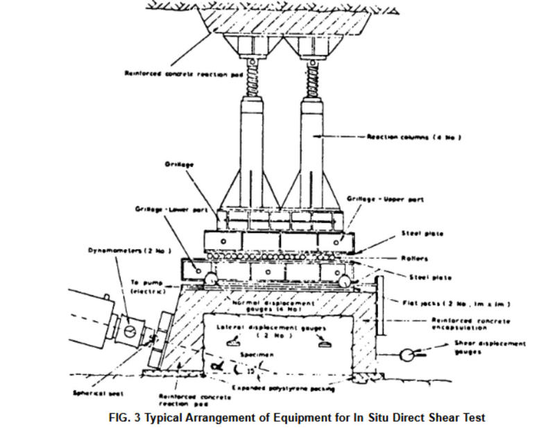

I am throwing out a thought that may or may not be taken up. Let's say the site hill up hill from the excavation has some form of "glue" or "temporary" adhesion that once disturbed results in a weaker shear strength test result. Thus any common sampling and testing method is likely to not show that added advantage. A common situation with partly saturated sand with temporary cohesion gives the same impression until dried. However,at the subject site the "glue" may be reasonably permanent and might not be taken advantage of with SPT estimates , etc..
I have run a few in-place direct shear tests that generally conform to ASTM-D4554.
Here is a link showing the test. http://file.yizimg.com/175706/2012051620512314.pdf
In my case I used a back-hoe with bucket resting on a support, as the resistance to push a calibrated hydraulic vertical jack against (proving ring). The horizontal push was supplied by a hand jacked hydraulic cylinder with calibrated pressure gauge to read the push being applied. This set-up has been used to get on-site shear characteristics for design of excavation bracing, waste product disposal pile stability, etc. It takes some time and field equipment, but I'd prefer it to any lab test.
One may have to run three or more separate set-ups since any "gluing" factor (if there is any) will be destroyed by each test run. For the sandstone I have experience with there is a form of glue holding the sand grains together, sometimes quite weak.

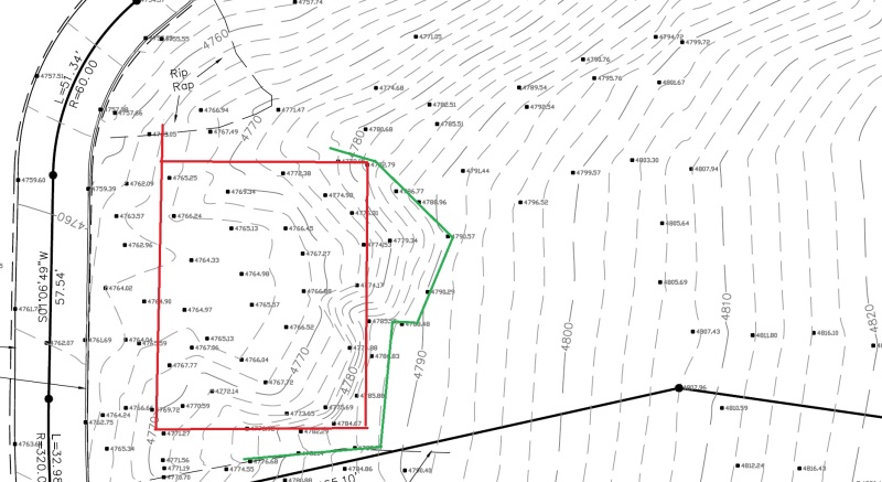

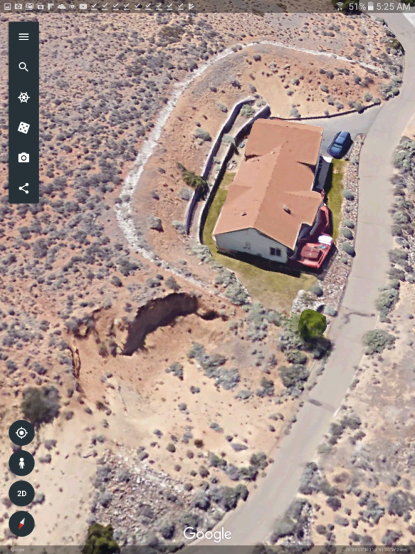

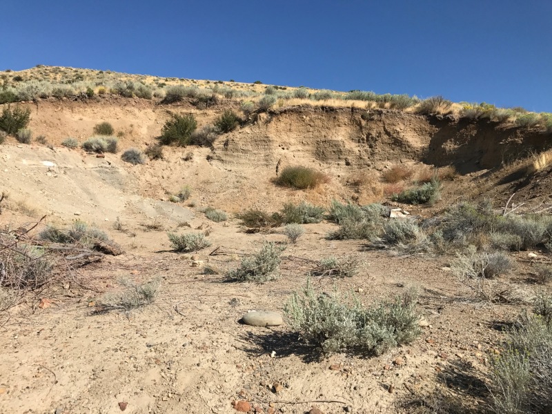

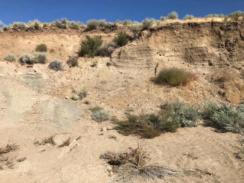

The hill was already partially excavated. There is an existing borrow pit there for more than 20 years. We hope to widening the pit and put the house there. The back-hoe cannot get to the top of the pit to sample because of the topography.
Here is the topography map with the house(red) and retaining wall (green)

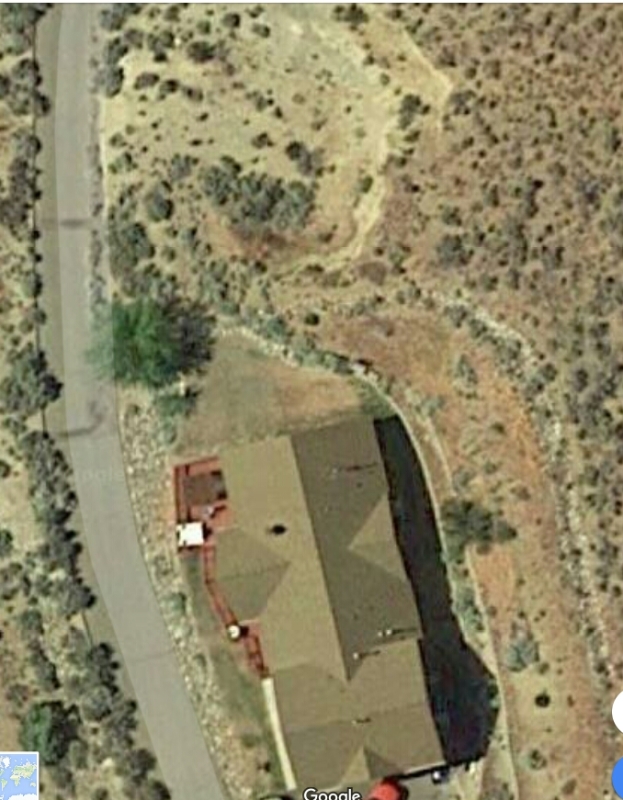

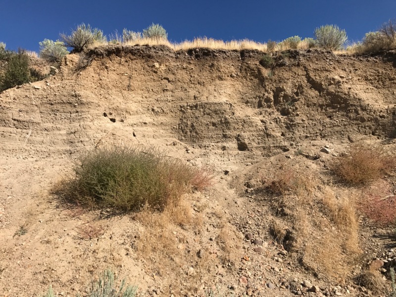

Here are the photos of the actual pit and the wall
Thank you again for your help!

The topog and photos help. However for scale, what is the size of the house rectangle? More constrast in the topog map drawing would help.
My first reaction is that there is some cementing of the sand to allow a steep cut to stand, but it is not totally stable. It appears that between el. 765 and 790 a possible earlier much higher cut condition was present and since then some failing of that cut has occurred. Not a good sign.. The sloughed piles give the impression that what you see is result of deterioration of the earlier steep cut slopes.
A geotech would be able to tell more of what is there, but it appears to be highly weathered sandstone. If that is the case,any steep slope should be considered as not permanent and some day will erode and maybe fail with large volumes moving. Simple slope erosion resistance may not be sufficient here. Thus an experienced geotech would be mandatory on the job if it was me. Access to the slopes above the old pit it must be obtained so that a drill rig can do the boring there. If needed use a tractor mounted rig.
The direct shear test I described might well also provide good info about what is there. It could be run in a test pit at an elevation midway between top of final cut and floor grade, off to the side. The object would be to test the layers that also are behind the cut slope now there.
RE: House's backwall as retention wall
Sorry for not including the scale. The red rectangle is about 60×80 feet

BTW, the next door neighbor was already built and the site has similar elevation.
Your neighbor cut back the slope to a stable condition with a few small walls at the base. If you have to keep a near vertical wall, look at some of these photos with tied back walls. Simple soil nailing is not suitable for what it appears you want. One slope in your photos is about 32 degrees, typical angle of repose for some sands. Cutting back to that slope would work.

While you are "playing" with various options, assume excavating a stable cut slope at 33 degrees to the horizontal (not allowing for possible cementing that may help), you need land extending up the hill about 60 feet for that cut starting at elevation 765 for rear of rear level place (lawn???).. Buy land back about 80 or 90 feet to be sure to allow for future unknowns. Might be cheaper than a tied back wall. A geotech might be able to recommend a less costly alternative.
