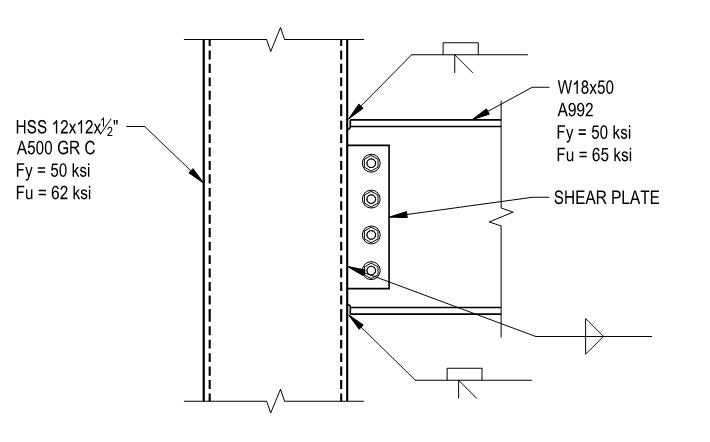

I've been looking at different schemes to do a moment connection between a WF column to HSS rect/square beam (both sides of column). A bit of odd case here. It will be treated as a OMF (not a pre-qual connection). I'm trying to solicit some ideas as all I can come up with is using a welded plate to top/bottom continuity plates. Any advice/suggestions?

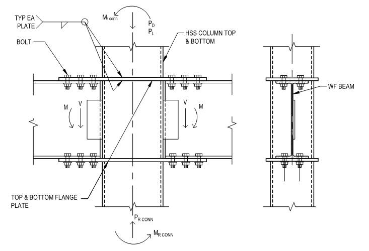

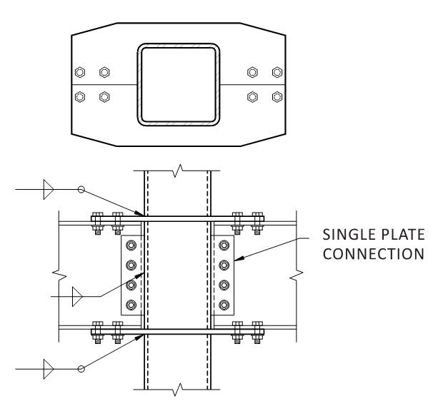

I thought you might appreciate some details for the common configurations. They're mostly just the concepts mentioned above by my cohorts. Obviously, some details are more expensive than others and your choice will be dictated by requirements for aesthetics, flexural capacity, and joint stiffness.
RE: Moment Connection: WF Column & HSS Beam
Appreciate providing the details. I think the first one with end plate might work for me...
