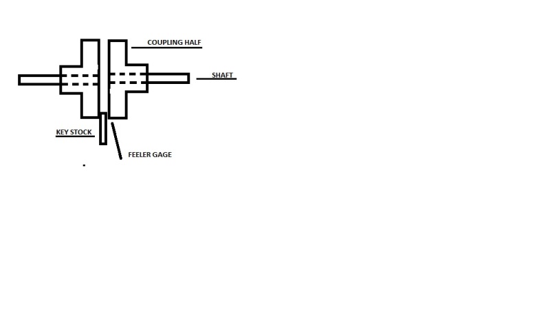

Here's an old school alignment procedure that may help:
Fix both coupling flanges on the shafts.
Leave the drive elements out of the coupling for now. Find something to use as a spacer between the coupling flanges.
Possibly a piece of key stock. You want about 40 or 40 thousands of an inch clearance between the spacer and the coupling flanges.
Now insert the spacer at one side of the couplings and measure the clearance with a set of feeler gauges.
Rotate the coupling halves about 15 or 20 degrees and recheck the clearances at the same place on the coupling halves. The clearances should be equal.
It helps to put a mark across the coupling flanges so as to always measure at the same place on the flanges as they are turned.
