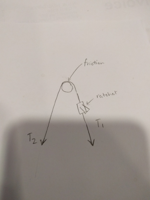

Hi guys,
Really struggling with something at the moment. We are designing some transport arrangements for an air transportable cabin. I have tried to attach a pic twice - hopefully it shows up.
We have two strapping scenarios that we are measuring strap tension using a load cell, one for a case and one for an ECU. Basically we have the case where one strap goes over the whole thing and the ECU where the straps hook to the corners ie the ECU has two straps. The problem we have is for some reason we can only measure roughly half the tension in the strap for the case, compared to the ECU straps. I have cranked the ratchet as hard as I can on both scenarios. For the case, i have tried putting the load cell in position 1 2 and 3 and all get pretty much the same result. To provide some numbers if i do the straps to a reasonable amount I get 200kg on the ECU and 100kg on the case. If I really try hard i can get 260kg on the ECU and 130kg on the case.
For the case, it should be pretty much just a pulley. So you should get the normal force on the case will be twice the measured tension in the strap (have allowed for angle but its pretty much vertical so can ignore it). But I dont see why the tension in the strap should change. There will be friction losses between the strap and case. But I think in the situation where the load cell and the ratchet are on the same side of the case that friction wouldn't affect it. I would expect to get less when the load cell is on the opposite side but this only changed it by about 10kg.
I think its too convenient that its halved. Also the case kind of deforms a bit. but i have tried cranking it more and i cant. Load cell is reasonably new and calibrated but again that shouldn't matter.
I have showed a few other Mech engineers at my firm and we are all confused. The only thing we can think is a combination of the strap friction, the case deforming and the extra strap wound on the ratchet (bigger lever to actually crank the ratchet) all contribute and its just a fluke that its half. It is making us feel stupid!
Hope someone can help.
Cheers

RE: Ratchet Strap problem
If the load cell is in-line with the strap, nothing else matters. All this talk about strap friction, or strap geometry, crushing the object, or anything of the sort, is irrelevant.
If the load cell is reading properly, it's telling you what the tension in the strap is. Your hand on the ratchet is what's tensioning the strap. Nothing else matters.
If the exact same interaction with the ratchet mechanism can generate two different forces, we could build a free energy machine.

But, to your second point- you can't apply double the normal force using the same amount of input energy.
The reflex for most people is to compare the two-leg strap arrangement to a pulley- but this is NOT a pulley. Erase that analogy from your mind.
When you tighten the ratchet strap, nothing moves. The strap acts as a spring, and the work you apply to the strap is absorbed as strain energy as the strap stretches.
The amount of strain energy you can put into the strap is always the same- it's based on the amount of work you can apply to the ratchet.
A spring with a fixed rate, which has absorbed a fixed amount of strain energy, can only apply a fixed force in any given direction.
Quote (Nescius)
This point is absolutely correct- but in the opposite way that Nescius meant it. The behavior you're seeing is such that the strap applies the same force to the object, regardless of geometry, because the level of work applied to the spring is the same. Hooke's law tells us that you can't double the force applied with the same level of strain energy stored in the spring. It just isn't possible.

Stiffness of the strap doesn't matter. Hooke's law doesn't matter. This is a statics problem. No consideration for the work done, or the potential energy of the strap, is needed. Somebody is pulling on a handle until a certain force on the handle is achieved.
Quote (jgKRI)
...you can't apply double the normal force using the same amount of input energy.
I assure you, I certainly can. That is the fundamental function of many devices.

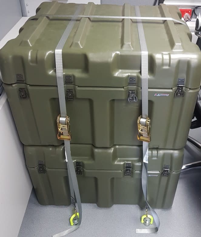

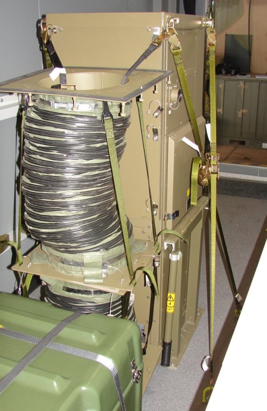

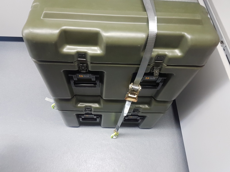

Dave the best i can do for you is these pics:
ECU. Ignore the ducts on the end. And the straps weren't crossed in the test. The Load cell was placed between the ratchet and the floor hook.
Case. As with the ECU the load cell was placed between the ratchet and foor. and was also tried on top and on the other side.

The case seems to have two straps going over the top??. Can you sketch out the exact strapping set up as this looks different to the ecu set up.
this is the complete case setup. Sorry thought i had already stated we tried with one strap by itself, as well as with the other straps on too. made no difference.
The ECU is exactly as per the picture in the OP but with one strap on each corner so 4 in total. As you can see in my previous post the strap attaches to a ring at the top of the ECU.

We used the same straps on each during the test. That is a pic from when they were actually packed ready for transport. and they are from the same manufacturer and have the same specs etc anyway, just different colour.

Look at the picture below. If there is friction T1 > T2. but the tension in T1 should be the same as if instead of a pulley it was a hook (and the T2 section didnt exist). Think about if instead of a ratchet there was a weight on the end of T1 and someone holding T2. The higher the friction in the pulley the lower strength required to hold T2 and the lower the tension in T2. the tension in T1 doesn't magically get less because of the friction. It still has to support the weight.
Also by trying the load cell in all 3 positions and getting the same result we have proved that the friction is minimal anyway.
The portion of the strap with the turnbuckle will have the higher tension because of friction. You must have mounted the load cell always where the turnbuckle was.
Read the OP and look at the picture on the right hand side. Where i have written 1,2,3 and circled them are the 3 locations we moved the load cell to and measured. The ratchet stayed at position 1 for all of the tests. we got pretty much the same tension in each location.

The load cells for the ECU and the case should have read about the same values( discounting friction at the corners, angle of the straps to the floor, number of wraps around the ratchets,etc...) when tightening the straps as hard as you can regardless on the attachment configuration over the case or ECU. You did not tell us about the load cells so I suspect that one load cell may have had a different magnification factor on their meters. The discounted effects in the parentheses above would affect the reading but not twice as much of a variation.
Thanks chicopee that was my thoughts hence the confusion. The loadcell was the same unit on both tests.

So, I see a couple of differences between the ECU and the case. The ECU appears to be an aluminum chassis, which the case is some sort of polymer (I guess). The other difference is the placement of the anchors around the two things. I don't necessarily think there's anything important relative to the anchor placements, but I would think that an aluminum chassis is essentially infinitely stiff relative to your straps, but the case probably isn't.

IR i agree but as the case deforms slowly i kept trying ot crank it further and further - thought that would negate this?
sorry explained that badly. i could crank it up to the point where i couldnt operate the ratchet any more. then the case would slowly deform and release tension (about 5-10kg of tension lost per minute). after a little while i could click it again and add more tension. but i could never get the tension as high as with the ECU (always around half) even when i couldnt physically operate the ratchet any further
