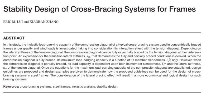

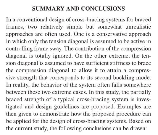

There's a great article in AISC's Engineering Journal - 3Quarter 2013.
Below is the front end summary and one of the concluding paragraphs:
If you are an AISC member it is free (or $10 if not a member)
Found HERE

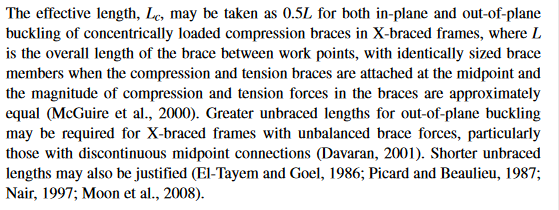

If you are actually concerned with bracing the compression diagonal with the tension diagonal, JAE's reference is one source, also AISC added the following to the Commentary of Appendix 7 in the 2016 Spec. (p. 16.1-569 available for free: https://www.aisc.org/globalassets/aisc/publication... PDF page 625)

I went looking for JAE's paper and it googled right up, for free: Link. The link is to AISC's website so I assume that there are no intellectual property issues. If someone knows otherwise, do let me know.
With the AISC blurb, what do we make of the "discontinuous midpoint connections" bit? Can we safely assume that we're good to go with K=0.5 so long as one of the braces is flexurally continuous across the joint? Conversely, if the brace forces are about equal, are we really able to go with K=0.5 even when neither brace is flexurally continuous across the joint? Pretty great to have an official AISC statement on this now.

Koot assuming you are using the k=0.5, instead of using it's equivalent of L/2?
RE: Questions about X bracing
Yup.
Quote (KootK)
No. The base paper only had one or the other discontinuous, though I see how that could be confusing from the verbiage. 2022...
