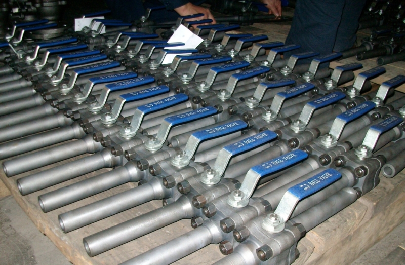

Dear All,
Could you pls advice whether the valves ordered are going to get supplied at site with open or in close position?
Question is applicable for any kind of routine piping valve i.e. Gate/Ball/Globe etc. but at the moment it is more specific for Ball valve (lever).
Pls let me know.
Thanks & Regards,
Abhijit

There is no standard shipping method. To save freight costs, the valves are packaged in the smallest shipping container in the safest shipping arrangement.
RE: Piping Valves are supplied in open or in closed position?
Haven't paid much attention to it, but all the valves I have bought in the last 6 months (about 30 gate valves, 12 ball valves, 2 ASCO solenoid valves) have all arrived in the closed position except for one of the solenoid valves since it was a NO valve.
4
For most valves, it is typical they are shipped closed to prevent debris from entering critical sealing areas. Butterfly valves are also usually closed to avoid damage to the sealing edge of the disc which can project out past the flange face. Ball valves are normally open so that any dirt or debris can easily pass through and not stick to the surface of the ball and possibly scratch and damage the ball or seat. Also this normally puts the handle in line with the flow port so the overall shipping package is smaller.

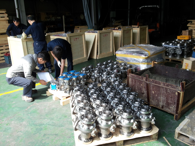

I should also mention, the ball valves and solenoid valves came with plastic plugs/caps covering the ends to prevent debris from entering the valve before installation.
Not sure I agree with bcd, the position is really only determined by packaging and handling. Spindle down is more compact, ball valve open is more compact, that is it. It may be an added advantage to try and prevent debris ingress but usually this is not an issue with packaging of smaller valves (like MFJewell also said). With larger valves the biggest issue I see is corrosion while in transport and site storage, which is a separate issue.
