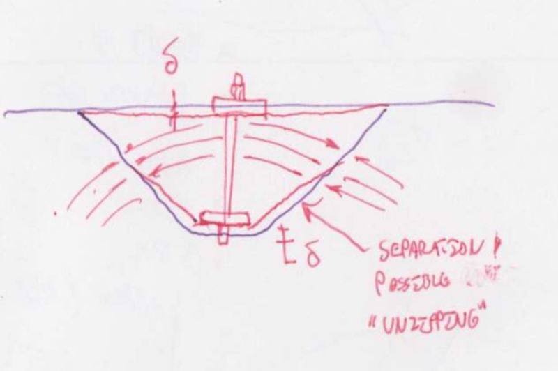

The sketch below shows how I'd sort of see Poisson's ratio leading to a fracture in spite of the fact that there's no net external load. Interestingly, there's another active thread here right now that's related: Link
Good sketch. It is analogous to bursting forces from anchorage of prestressed tendons.....only difference is: the "edge" in the compression direction is mighty close. There is no reason to believe all the compression forces from the end nut/plate are going to run straight to that bolt head. (It's not "smart" concrete.)
I think stiffness is playing a role here as well (as always). Referencing the testing I mentioned before, the guy mentioned that the break out "cone" (or cracks) in some cases was much smaller (in radius) than it should have been at the surface. I think what is happening there is a concrete "sleeve" (around the bolt) forming when it gets tightened. (Analogous to a bolt in a canister.) Under certain circumstances, the "sleeve" is stiff enough to attract force it can't take. (And not ductile enough to avoid breakout by giving a bit and making the concrete directly under the head take it all.)

I'm not sure I fully agree with the above sketch - see my idea in attached jpg.
I don't believe a nice cone-shaped chunk of concrete would come loose after overtightening a similar set-up.
I'd buy that cracks would start to run first in a "horizontal" plane, then either 45° upwards or downwards, initiating from the bottom washer/plate.

I neglected to show something somewhat important in my sketch. There should also be some high, local tension forces in the concrete across the failure cone near to where the crack tips open. Essentially, you get a crack chasing it's way up through a brittle material. Without those tension forces, my sketch would not quite be in equilibrium.
