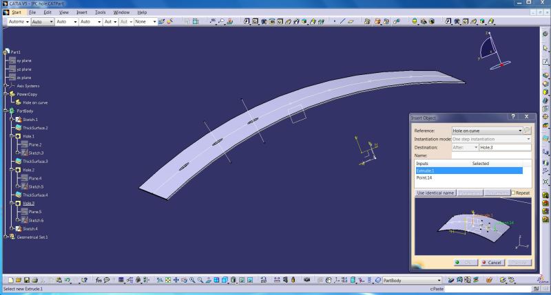

Unless LWolf comes up with an alternative procedure, per my research so far, the above may not possible in Catia V5 using out-of-box command/option. Powercopy seems to be one procedure but I dunno how to automate it...else I will have to click 300+ times to make it work...plus I was not able to get the Hole feature to be included in Powercopy.
Yes on a simpler curved surface part, I did try creating a plane tangent to the point on a surface and the hole was generated on that plane along a line I created (normal to the plane+point). Still had issues including Hole feature in Powercopy.

Beautiful! Is it possible to post a higher resolution of your Catia model tree or share your Cat part? Just curious to see how your were able to accomplish the above. I am having hard time making out the model tree from the above image.

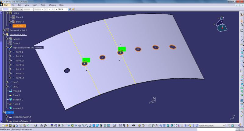

The attached image shows a Hole (Up to Last) being replicated via the User Pattern function on a compound surface. The Yellow hole is the hole that is patterned; the Green holes are the ones generated by the pattern.

does the axis of the hole keep the same direction or does it follow the normal of the surface? I have the feeling they all have same axis.
in order to have axis normal to surface we developed a script CAA but VBA or even EKL (knowledgePattern) would be better

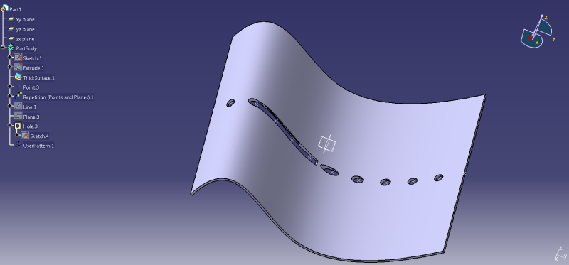

I tried to pattern a Hole on a highly curved part. I used Surface Normal in Hole definition box as well as "Keep Specifications" in User Pattern definition.
As one can see the result is not at all along expected lines.
The feature Hole.3 (left most one on -Y direction) is the original Hole feature.
Anyways, I think I've figured out on how to use Powercopy to instantiate multiple Hole features on a part like the above.
