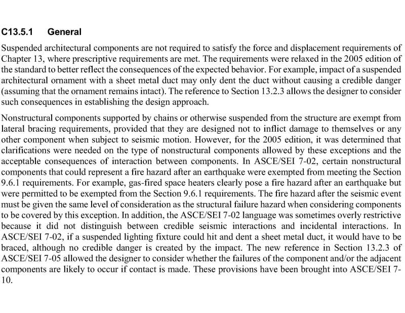

ASCE 7 13.5.1 allows suspended nonstructural components to be installed without lateral bracing provided they meet the following criteria:
1. The design load shall be taken as 1.4 times the seismic weight acting down with a simultaneous horizontal load equal to 1.4 times the weight.
2. Interaction effects need to be considered so that if the component impacts another object during an earthquake it does not pose a threat to life safety or cause failure of an essential component. See below for additional commentary.
3. The connection to the structure shall allow for a 360 degree range of motion in the horizontal plane.

UPDATE for anyone in the same situation in the future:
So after a bit of thinking and research, I've decided to insist that the artist provide a minimum of 3 wire supports per glass piece, each wire out of vertical, as well as rigid bar spacers between wires of adjacent glass pieces, located close to the top of the glass pieces.
