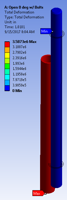

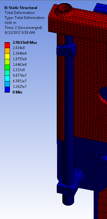

I don't think I can share the model since its proprietary information. I can share the screenshot below showing the behavior I'm seeing. I don't currently have results showing the behavior with the bolts, but I'll try to generate some of those as soon as possible.
Any idea what might be causing this to happen? Here's the settings for the contact connection there:

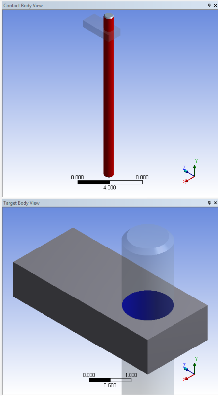

And here's the surfaces in contact:

Hi tlewis3348,
There was no numerical scale on your plot. Was the displacement small?
I'm not sure if this replicates your setup. (Note that Ansys Auto Scale is at 6400x magnification below, making it look weird):
The original geometry was a simple cylinder in block with no interference but the hole diameter is the same as the cylinder diameter (10mm):
The reason, as I understand, is because the mesh is not exactly coincident. From the end view, the mesh has tiny interference:
Once the mesh is lined up properly, the interference is negligible:

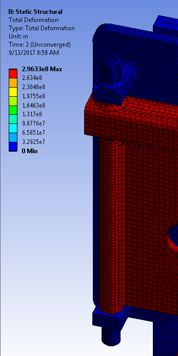

As far as how much magnification was in the image I showed above, I ran that simulation quickly just to get a screenshot of the behavior I've seen above. Therefore, I didn't let the simulation run for very long, and just magnified the results to be similar to what I'd seen before. Whatever the case, the magnitude of the effect depends on how long I let it run. If I let it run for a while, the effect can be quite significant at 1X scale. Anyhow, I will try aligning the mesh and see what happens. Thanks!
RE: Modeling Bolts in Shear
So I just did the simulation with the mesh aligned, but it is still producing the bad results:
This is at 1X scale. Note that these results are not converged because the simulation crashes before it will finish. Ultimately, the only way I've found to get the simulation to run without crashing is to use joints to represent these interfaces rather than frictional contact. This problem is though that apparently joints are only valid if you can accurately assume that the joint won't fail in reality.

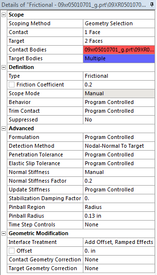

So between the blog shared by @L_K and the tutorial on contact in ANSYS here: http://inside.mines.edu/~apetrell/ENME442/Labs/130..., I changed the contact detection method to "Nodal-Normal To Target" and the normal stiffness factor to 0.2, and also changed the pinball region on some of my contact sets to be non-zero. However, even though I did that, I'm still getting incorrect results. Compare the deformed on the left (scaled to 2e-8 X) and undeformed on the right results shown below:

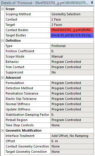

Clearly, whatever settings I have for contact between these two parts is not effective at enforcing contact between them. These are the settings I'm using:
Note that the diameter of the pin is 0.25in smaller than the diameter of the sleeve, which is why I set the radius of the pinball region to 0.13in.
Any suggestions as to what settings I have wrong would be greatly appreciated. I feel like I'm shooting in the dark here.

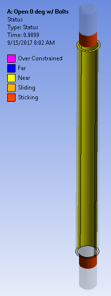

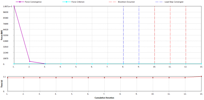

What was the error message?
How does the force convergence plot look like?
Does your Contact Tool>Status plot show the friction contact as "Far"?

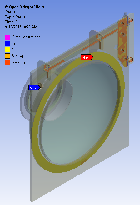

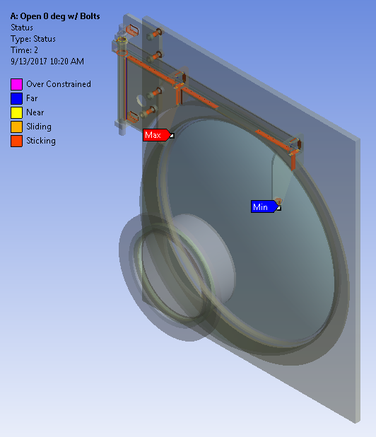

Here's the force convergence:

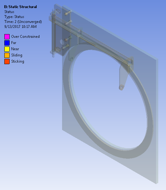

Here's what the contact tool status plot shows:
For comparison, when I do the same simulation with joints representing the contact (i.e. in a simulation not getting these crazy results), this is the results of the contact status plot:
The error indicates there is an unrestrained part. I assume the flying part is the colored red in your earlier picture and it is the same part you are trying to clamp with bolt preload.
Some suggestions:
1. Would it be possible to apply a temporary displacement 'support' on a small section of the 'red part' to avoid rigid body motion, apply your bolt preload, lock it, then remove the temporary support in the next time step? This should help keep the model from flying.
2. I noticed the red part has a thin face that is 'Near' (Yellow circle in this picture). Could you modify the geometry such that it is line-to-line to the contacting part?
Quote (OP)
ANSYS ignores the contact at the start of the simulation and never reconsiders it later
There is a vertical blue line in the picture which I assume shows the contacts are 'far' between the pin and the sleeve.
Other suggestions:
1. Increase the pinball radius (say... 1 inch).
2. In geometry, move the door such that pin and sleeve are touching near where they are expected to.
Kind regards,
Jason

Now, to be clear, the solution has obviously not converged. Here's the force convergence plot:
So I finally got it to work. There was a tiny gap between the sleeve and the hinge pin that was not completely closed when I initially moved the parts, and between that and reducing the initial substeps down to 1000, the simulation finally ran correctly.
Thanks so much to both of you for all your help! I've definitely learned a lot!
