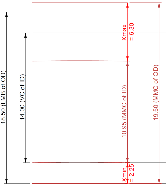

MIN = 2.5 mm
MAX = 6.05 mm

Pmarc,
Should we use 18.5mm as the LMB size for datum feature A?
Also please correct me/educate me if I am wrong, perfect form at MMC is still needed for the OD and perfect form at LMC is only mandatory for the ID?
What are your x min and x max values?

RE: Stackup calculations (X min / X max.)
greenimi,
My answer to your first two questions is yes.
My numbers in the third question are 2.25 for Xmin and 6.3 for Xmax.
J-P,
For the consistent wall thickness the answer is the same as for the wall thickness at a cross section.
To get the 6.3 wall thickness value**:
{ LMC OD 19
+ 3 * OD_TOL 0.5
- LMC ID 11
+ LMC Pos Tol 3.0
- 2 * ID_TOL -0.05}
3DDave,
The 6.3 for Xmax was calculated with the assumption that the LMB size of the datum feature A (18.5) is not equal to its LMC size (19.0). If you did the same thing, your derivation would be like this:
The diameter of the OD at MMC is 19.5; the LMB diameter is 18.5 so the farthest the datum simulator can travel is 1.0.
The distance from the far outer wall to the offset datum simulator center is 19.5-(18.5/2) = 10.25
The distance from the center of the datum simulator to the center of the shifted MMC hole can be (3 + .05)/2
The radius of the hole at MMC is (11 -.05)/2; subtract the shift from the hole -> (8 -.1)/2 = 3.95.
This is the distance from the offset datum simulator center to the far wall of the hole.
Take the difference 10.25-3.95 = 6.3

Hi All,
After all that effort, I mistyped one of the values in my previous post - I meant to type 2.25 and not 2.35. No, really, I had it right and didn't have to look at pmarc's calculation ;^).
I used a different method to calculate the result. I sketched the boundaries and an extreme as-produced feature, and then measured the wall thicknesses.
The black lines are the boundaries and the brown lines are the as-produced part.

Seasonlee,
Draw a banana shaped cylinder with section dimension of 19 inside a 19.5 boundary. You lose .5 on each side.

greenimi,
Thanks. I actually didn't even read pmarc's or 3DDave's derivations in detail. I have a hard time thinking of these things in terms of center geometry and radii - I do much better with diameters, and the surface interpretation. I also need the picture - I can see things in my mind, but only up to a certain level of complexity.
I agree with 3DDave that the lack of a "means this" for Fig. 7-17 is a concern. The only explanation in the text is "allowable displacement results when the datum feature departs from LMB". It appears that Y14.5 didn't think through the implications of a datum feature referenced at LMB, but without a tolerance referencing it at LMC (that would switch the perfect form boundary to LMC, according to the special rule). I don't think that this figure (or its explanation) has been changed in the new draft, so there must not have been many (or perhaps any) comments on it during the review process.
Ah yes, you are right, Evan. The figure is in the draft indeed - it is now fig. 10-18. For some reason (most likely because it is in chapter 7 in 2009 standard) I also searched in chapter 7 in the draft. My mistake.
As for your question, perfect form at MMC would not be required in this case. Para. 2.7.1(d) in 2009 standard does not explicitly say that, but fortunately in the draft it was clarified. Para. 5.7.1(d) says: "Where a geometric tolerance is specified to apply at LMC, perfect form at LMC is required and there is no requirement for perfect form at MMC."
I'm confused about how we're getting 18.5 from "19 +0.5/-0"?
The maximum diameter is 19.5 so that limits the form. At 19 the outer part can bend to wedge into that 19.5. In the bent condition the largest perfectly formed cylinder that can fit is 18.5.
If you draw a picture of these steps - 19.5 diameter, bent 19.0 local size minimum, and then fit a cylinder that lies fully within the bent 19. local size bent version you'll see that you loose .5 from one side of the 19.5 and an additional .5 from the other side.

Quote (Belanger)
That's not the same example really, because that doesn't have LMB on the datum reference.
Right. Unfortunately, there is no similar example using LMB. If you want to use Alex approach, the trick is to use 18.5 as LMC. Where the VC=MMC size (19.5) or min datum shift=0 (|MMC rad-VC rad) and the max datum shift is 1.0 (|LMC rad - VC rad|)
I mean, what's the definition of "perfect form" here? If the hole tolerance tells me that it applies only when a Ø19+0.5/-0 shaft is at LMC (and therefore "perfect form"), shouldn't that mean only when you've got a perfectly straight Ø19 shaft in which the upper limit doesn't come into play?
The perfect form limitation only applies at MMC unless the feature itself has a geometric tolerance that applies at LMC. Since the outer diameter has no geometric tolerance applied, then its perfect form is at MMC.
