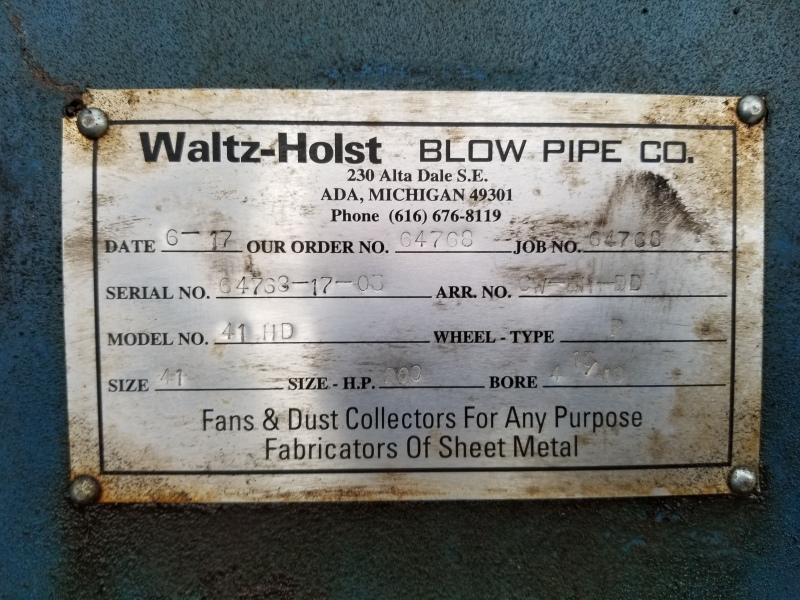

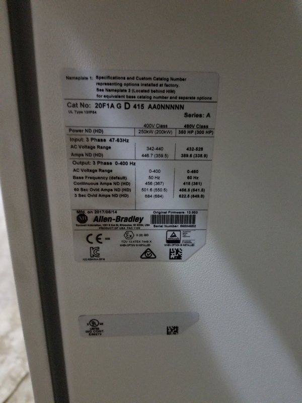

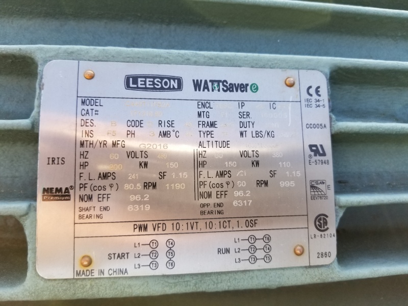

FAN DATA:
Fan Diameter: 72 inches
Fan Width: 19 inches
P Type, Forward Pitch
Measurements are the actual fan
MOTOR DATA:
DRIVE DATA:

Why would someone hook a 150HP motor up to a fan with a 200HP requirement?
Keith Cress
RE: Motor/VFD Question
Keith,
That's the 380V / 50Hz data on the right side of the plate.
It's good for 200HP / 150KW at 460V / 60Hz
AHh. Thanks for that Scotty. I've never seen that on a motor plate before! Lots of info, unlike the blower plate that doesn't even state the RPM. LOL
Keith Cress

Quote (From the drive nameplate:)
250 kW (200 kW)
Continuous Amps 456 (367)
60 Sec Amps 501.6 (550.5)
Looking at this information there should be no way that this drive will reach a current limit of 275 Amps in 30 seconds.
Possible causes.
1 The drive is configured for less than 250 kW or 200 kW
2 The drive has other configuration issues
3 The drive is faulty
It seems strange that the 60 seconds Amps is lower for 250 kW than for 200 kW.

Assuming the fan is 80% efficient, it could move 51,000 cfm if the fan outlet pressure is under 10psi. So, what is the fan outlet pressure?
The VFD will be fine with a delta connected motor. The motor connection doesn't matter as long as the motor and the VFD V/Hz pattern match.
I find it odd that the manufacturer plated the fan with the HP but without the rpm. That's a really odd thing to do for a fan since the HP is useless without the rpm.

@LionelHutz: At ~18Hz, we are drawing less then 1 inch WG on inlet side of duct. It seems to me that there is hardly any load at all.
I agree that the VFD should work fine on a delta connected motor. Can you elaborate on motor and VFD/Hz pattern needing to match?
Again I agree, the fan manufacture indicating the HP without indicating RPM for the equipment is odd. I can only speculate from the motor they installed that the operating speed of the fan is 1160RPM.

So what I'm curious about is the "old vs new" fan issue. Going from 36" diameter to 72" diameter represents a HUGE difference in inertia of the fan blades themselves. So was the 36" fan using a smaller motor so that when you changed to 72", the motor size was increased too?
Also I agree with LH, stating the fan HP requirement without stating the RPM is very odd. For all we know, that 72" fan was intended to run at 10RPM and the 200HP assumed a 6:1 belt reduction, meaning the torque requirement if directly driven would be the equivalent of 1200HP! I just really think there is some sort of mechanical mistake taking place here and some mechanically inclined person is thinking the VFD performs magic. I've had that happen in more than one occasion.

The motor is rated 460V @ 60Hz. this means it has a V/Hz ratio of 7.67 and the VFD needs to be programmed to match this ratio. There are various ways this is done and a typical way is programming motor voltage to 360 and a base frequency setting to 60Hz. However, I can't say how to do this exactly with that VFD.
Did you take any rpm measurements when connected in wye? It'd be interesting to know what rpm the motor and fan achieved.

From the spec plate it appears as though the drive may be either a 250 kW drive or a 200 kW drive.
Is this something that is set in the parameters?
If the drive was inadvertently configured to 100 kW, that may explain the low current limit.
Is this possible Jeff, or am I lost in lala land.

@waross: The drive is a setup for 480 Class (right data column of nameplate)

I'm pretty sure the problem is in drive current measurement.
Y motor connection is working and for 48Hz output, motor torque result about 2000Nm... much above maxim motor torque.
In delta, FLA is reached at lower speed but real current is much smaller than what drive see; this is the reason drive stop at 18Hz.
