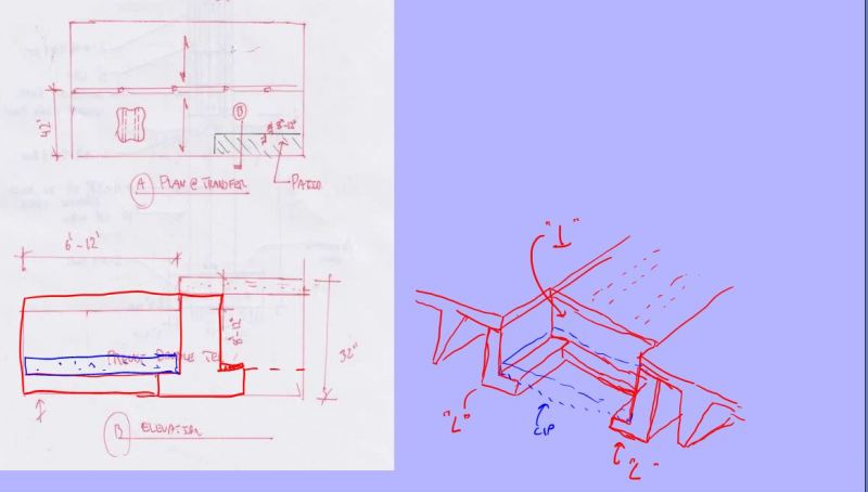

See the somewhat fictionalized rendition of my project below. Originally, it was desired to use hollow core precast plank for this second floor transfer slab. Somewhere along the line, before it landed on my desk, it was concluded that the spans were too long for 12" HC and that a double tee system would be better. As things have progressed, the question has arisen "how do we handle slab depressions?". Without egregiously sacrificing the economy of the TT's, it seems to me that they really cannot be handled.
Before I throw in the towel on this scheme and try to steer things in another direction, does anybody know of any tricks for making a go of it with the TT's? While I haven't done a TT transfer slab before, I know that it definitely has been done before. I'd think that this would be a common problem in need of solution. The only simple idea that I can come up with is to do it all in the topping. But, then, that gets heavy, expensive, thick, and generally ridiculous.

Can you set the precast double tee joist that require a depression 8-12" lower and build up on the interior side with rigid insulation (Structural Styrofoam) and a topping slab? Might lead to some tricky attachment details at your supporting member and I am not sure if you have the height below....

Thanks for the suggestion EZ. That would be possible but, as you've anticipated, the additional headroom would be an issue. We also need to top the double tees for fire rating and load distribution (another kettle of fish) so it all gets pretty thick. Lastly, my real building actually has depressions all over the place. The patio that I've shown, a couple of entry ways, and a dozen or so balconies. I'd wind up dropping pretty much the entire deck to get it done.

What's the purpose of this depression? I'd think ANY flooring system would have difficulty handling what in essence is an unframed 12' x ~50' opening, it seems unfair to blame the double tees, heh.
What's the loading on the floor? 42' is well in the ballpark of 12" HC for most uses.
The usual business where the interior and exterior walking surfaces are at nearly the same elevation but the exterior has a bunch of building envelope stuff piled up on top of it.
A common permutation of this is to run hollow core in in other direction, drop the edge planks has needed, and smooth out the odd bits with topping. It make sense when you've got a high aspect ration building with all of the depressions on the long sides, which is normal.

It carries three floors of wood residential structure coming down as line loads parallel to the plank. Parallel, at least, for now.

As far as solutions, I can think of a couple options (assuming "frame it in a sensible way with a beam where the depression edge is" is a no go):
1) Cast on a flange at the correct height after the double tee has been poured, prior to erection (it would have to be post-pour as I'm not aware of any double-tee forms that can accommodate a jog in height like you're showing). This would be kind of a hassle (read: $$$), and you'd likely get some gnarly stress concentrations at the edge of the depression where you have a discontinuity, but your span is low enough and your section deep enough that you could probably make it work.
3) Frame the whole thing with light gauge after the tees have been erected. The issue now is that your "tee" is spanning 12 or so feet with 12" of missing depth and no top flange, but again, it's possible this is workable with the span and tee size numbers you're working with. You could also look into combining this solution with a deeper tee at this section (you'd have to ask around for a precaster that has the forms for them), though then you run into headroom issues.
You also might look into framing this area with single tees - you run into the same problem, but single tees tend to be able to handle a lot more capacity, so might work better.

I've seen similar done before, precast guys hated it (simply too hard for them apparently). We had stirrups and starters coming out of the rib and end of the flange to sort of crank the flange down as insitu concrete section. We reverted to just setting down the entire units and dealing with the additional dead weight because precast guys were to inflexible.
Our set down was only 3" from memory, yours is a lot more savage at 8-12".
I'd look at ways of reducing the set down, it's a case of the architecture needing to follow the practical engineering realities. We do our best but sometimes the architecture needs to pull its head in. Perhaps a cutoff drain at the threshold can allow for a much smaller set down for example, or a fall away from the building to allow less set down.
Lastly might just need to throw through additional beams to frame out the lower portion, or turn the floor system 90 degrees locally and span the other way if it worked for your wall loads. You could have ribs at closer centres if it was an issue.

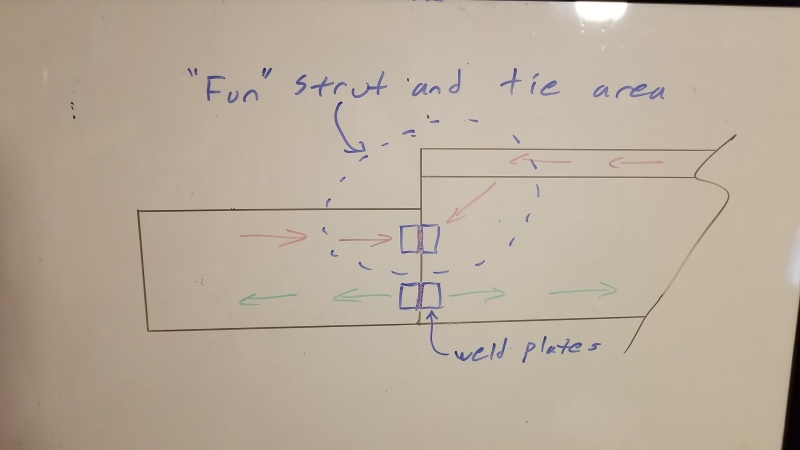

KootK, what about this for an option? Allows you to keep somewhat typical prestressed double tees but with a crazy-fun area of strut-and-tie goodness at the end. Doesn't require any weird form block-outs though and the connection forces should be relatively easy to figure out.

Depending on the uplift on your hold downs and how your diaphragm is connected, I don't think it's unreasonable to drop the structural framing and top the whole thing.
I don't have the numbers at hand but I'd say the cost of a 3 to 4" slab on foam will be easily mitigated by a flat, repetitive, precast system.

Never. That's kind of voodoo that I recommend for other folks but would never have the balls to execute myself. I'm not sure that I could go on living knowing that three stories of building is depending on that weld plate in tension not ripping out. Curious, would you be willing to do it? As a precast specialist, I weight your opinion quite heavily in these matters. As a solution, it's clever and innovative, no doubt.

Not unless I could overbuild the hell out of it and have a quality welder. I'd also want 4 weld plates per stem for redundancy.
Now that I've slept on it I've decided I don't like my own detail as it could have a big issue if any corrosion occurred and would be difficult to repair. Maybe it could be improved if the dropped area was a secondary pour with rebar extending continuously from the double tee into the dropped area?
Anyway, scratch my idea. I'm sure it could work but cheaper and likely better to just have a blocked out area of a double tee and go from there.

I'm more just throwing ideas out to see what sticks so this may work just as well as my weld plate idea; but what about a hybrid composite steel beam mixed with the typical double tee framing?
Don't have time to sketch it up but use a steel beam that matches the higher and lower profile you have. Have the beam cast into either a precast slab section or a cast-in-place slab to get the profile you need and give composite action for the beam. Design the beam to have similar deflection response as the double tees (matching the camber of the double tees will be interesting). Install adjacent to the typical double tees an go from there.
No idea if this will be something that meets the project goals/cost/etc. Like I said, just throwing out ideas.

The success of a welded stub would depend on a lot of things in my mind. Rust would be a concern for sure, but with proper details it could be protected. Something along a cazaly hanger might work if it could be concealed well. It is easy to be very conservative with something like that since you can spec a lot of extra weld and use much larger bars without adding much cost. The weld quality issue is likely not a huge concern since the welding would likely be done in the shop by the plant welders.
