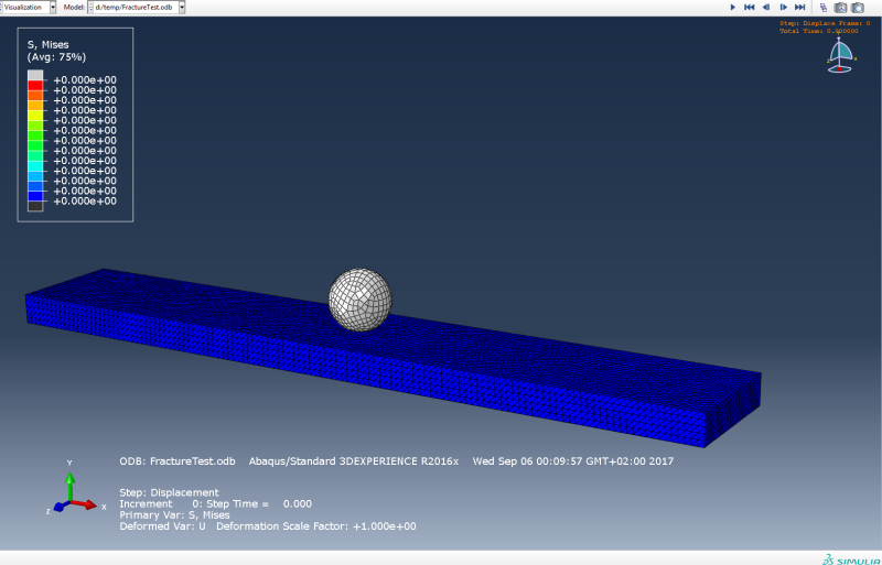

I just want to know, must I define the constraint(the third button in interaction)?
Because when I don't do this step, I find only the ball moves, but the beam don't bend. It's confused
RE: Questions about Abaqus Interaction and Deform
You have to define contact (aka interaction) between the beam and the ball.
