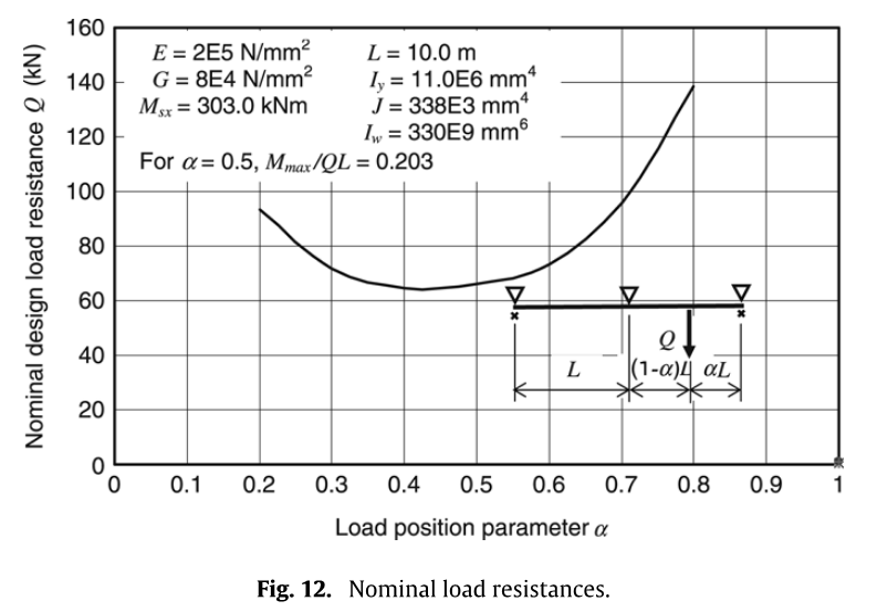

"Lateral buckling of monorail beams" by N.S.Trahair in Engineered Structures; Volume 30, Issue 11, 2008 pp 3213-3218: Link
It is a fee-based download.
Trahair covers two-span continuous monorails (bottom-running cranes), as well as single span, cantilevers, and overhanging (cantilever with back-span).
His approach is essentially an elastic buckling analysis, using simple closed-form approximations (backed up with FE simulations). He does NOT consider distortional buckling in this paper. It has a worked example of a 2-span, top flange supported, bottom flange loaded, monorail, of WF (I) section. It has a Australian code reference (Trahair is a retired prof from Uni of Sydney) but his approach is somewhat 'universal' for EC, AISC etc codes:
