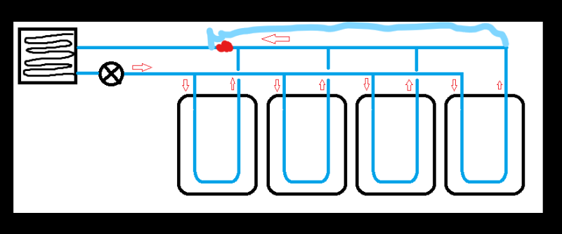

I'm working on a task which is very much not my area of expertise, and I was hoping you might have a few pointers.
I'm basically creating a rudimentary liquid cooling system, where a pump is supplying coolant through a pipe, which is split off into four liquid tanks, and I'm looking to make the flow through each tee as even as possible.
I've attached a crude mockup for illustration.
The pipes going into the tanks are MDPE SDR11 (material constraints) 25mm OD 20mm ID, and roughly 20-25m in length. The total flow rate from the pump is to be 100 litre/minute with each tank ideally receiving 25 litre/minute.
The distance between the pump and the final tank is ~30ft. I have scope to constrain things further as needed, but at the moment they're quite open ended.
Any advice on where to start would be greatly appreciated, as well as any general design advice. Would I be best using straight tees, or 45° angled tees?
Thanks in advance for your time.

You need to aim for equal resistance/ length as a simple way of doing this, or add in some variable flow resistance. As it stands the first one or two tanks will take most of the flow unless the flow resistance/frictional losses in the tank is very high compared to the losses in the pipe.
At only 30 ft in length I would take the return leg from the right hand end of your diagram for the return leg. This needs a bit more pipe but then you can see that total pipe length of inlet and discharge pipe for each tank is the same.
An alternative is to make the inlet and return pipes very big compared to the tank inlet lines so that the pressure losses in the pipes were very low.
If you really need 25% and not 24 or 23 then you need flow control valves.

>At only 30 ft in length I would take the return leg from the right hand end of your diagram for the return leg. This needs a bit more pipe but then you can see that total pipe length of inlet and discharge pipe for each tank is >the same.
By this do you mean to run the pipe from each tank to the far end, and join with the return there? Makes sense, as you say, to equalise distances.
What would you consider "very big" in this scenario?

N, what I meant was that on the diagram you provided break the pipe where I've drawn a red bit and connect to the far end of the return header. Then the total length of inlet and return pipe lengths for each tank are similar ( not truly identical) but if you only want to get within 10-15% variance then it's probably good enough. A lot will depend on the relative pressure losses in the pipes compared to the tank cooling system losses.
Very big - say 4 times the diameter of the tank inlet so 100 - 150 mm or so for the inlet and return pipes

You could also have the supply and return headers enter and exit between Tanks 2 and 3 to minimize the difference between Tanks 1 and 4.
