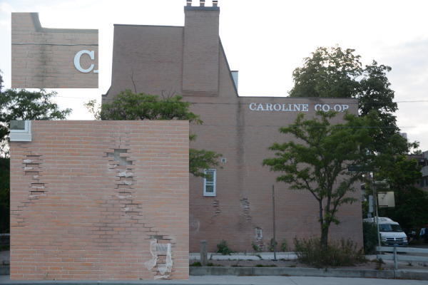

I was walking down Parliament Street towards the Gardiner Expressway in downtown Toronto, Canada. This is a scary sight. I searched Google for this and I can find nothing.

I don't see a pile of bricks near the base of the building, so presumably someone has been picking up the bricks as they fall off and is aware of the situation (along with everyone else who walks by the building).
As long as there are adequate brick ties securely fastened, the brick fascade may not be in danger of peeling away from the building. As for the vertical load, it appears as the brick has chosen to resort to arching action above the missing bricks.
At the very least, I would expect water issues. At some point, it could cause a catastrophic collapse if enough water got behind the brick, froze during those Toronto winters, popped more brick off the wall

Looking at the stripe up the wall to the roof transition I believe that there is already a lot of water behind the brick.
It may be that the wall is failing and 'pushing' the brick off.
Surprised if a city inspector hasn't made a visit.

I did not walk around to the side to see if the house was occupied. It is possible people already have been moved out of it. It is the end of a row of townhouses, so this is a mess.

Can you take a bunch of photos, close up? to see where the source of water may be as well as the type of deterioration of the brickwork? Can you also post the address and the type of use for the building?

The property owners may be battling the city about who is responsible. If you swing 180 degrees from the view of the wall on google street view Link, you will see pallets of grout. If you then proceed around the building on to Longboat Ave. You will observe that the street has been torn up to do remedial work to the storm water system. Hard to say if one is related to the other. What is scary is the portion of the wall that bears the Caroline Co-Op signage is freestanding to about the chimney transition.
