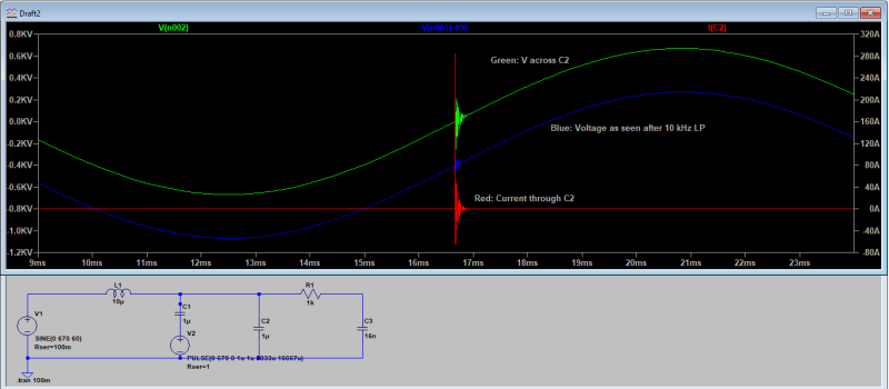

RE: Supply resonance theory.
A simulation (
CODE --> Swedish
[code ]
[/code]the exact data are not available) shows what I mean. During start of a motor, there will be short pulses injected to the line. These short pulses/ringing will then affect all capacitors that are connected to that transformer. It is a real possibility. And I have had that problem in light fixtures with PF capacitors. Dimmers in another part of the building (for heating, that was) killed the capacitors.
Shown in the diagram is also the 10 kHz LP filter and the voltage you will see with a 10 kHz recorder.
