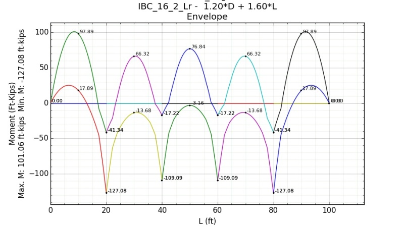

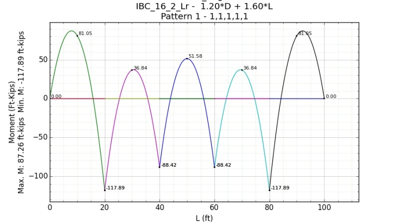

Patterning of roof live, snow, and rain loads will also have a large impact on the design.
Below is DL: 1 klf and LL: 1 klf on all spans with patterning considered:

See attached revised Moment diagram for plastic design. Envelope similar but due to distortion of end spans... only an approximate view. Also load factors slightly different.
In case anyone is curious, I copied the OP *.jpg into Paint.Net program (a very good freeware graphics program) and exported it as a *.pdf. I then used Adobe free pdf reader and added the lines... Paint.Net is a little brother to Photoshop and extremely good.
