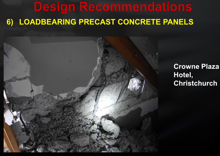

Part of the reason is that concrete is much stronger over time than the design value, so rather than forming distributed cracking to dissipate energy you get a single crack (with lower reinforcement ratios at least) and hence reinforced capacity can actually be lower than the uncracked concrete capacity. This generally results in bar fracture due to low cycle fatigue after a low number of cycles, as might occur in a seismic event.
As I believe it the intent of the recently updated NZ provisions are essentially making sure that the walls behave almost in an elastic manner up to the Maximum Credible Earthquake (MCE, 2500 yr return period event).
There might be laboratory testing to show they are robust, but real events in NZ recently generally showed in certain circumstances very poor performance.
