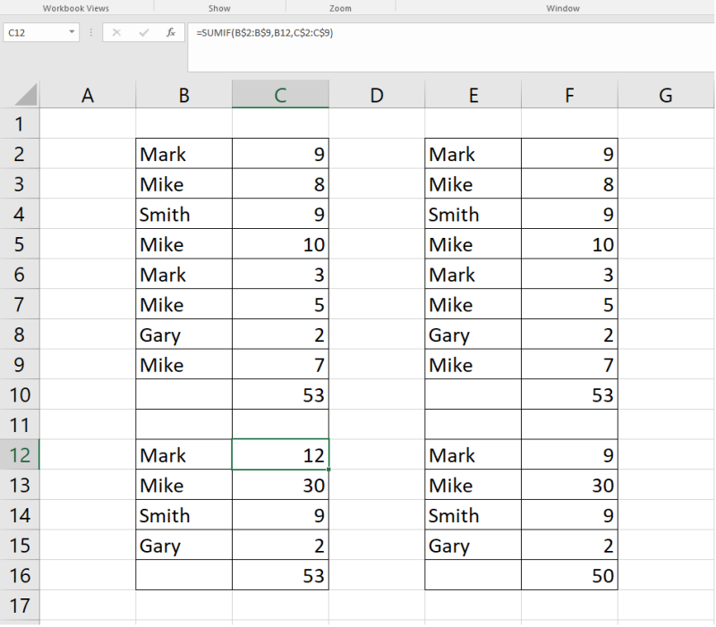

You can also use SUMIF, see screenshot below. I have set the data range as a Table, but you don't have to.
Enter the formula as shown for the first name, with the first and last ranges absolute and the name range relative, and copy it down

I do this task like IDS all the time
but, especially if someone else is doing data entry for me, add a validation to the cell with names in case of a misspelling, or, less obvious, adding mistakenly a blank space after a name. for example mike(space) (5 letters) will not be added to something looking for mike (4 letters)
likely there is a more elegant way, but this works for me

RE: How Can I do this in Excel 2016?
by spaces, i simply am meaning data entry error...
as example, the formulae below are the same as IDS above, but answers differ because data entered differently
eg.... "Mike" (4 letters) vs "Mike " (with space at end)
edit.... see my own data entry error.... i meant "Mark" vs "Mark "
