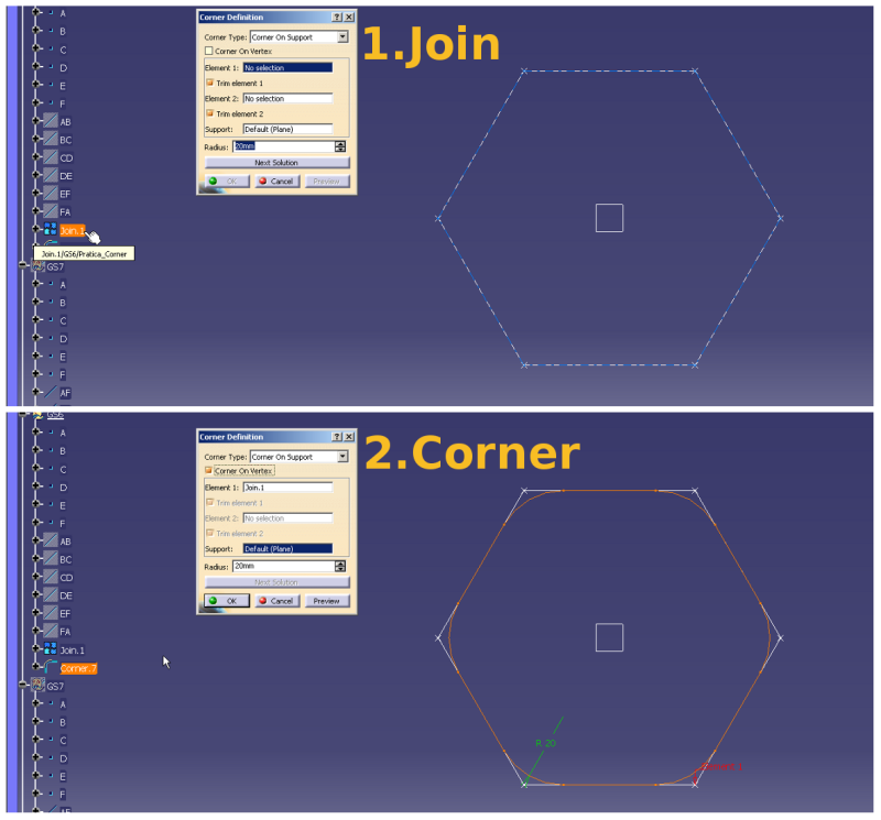

I'm working on a macro to automate the corner creation in a sharp-edge geometry.
From previous attempts, I noticed that the parameters of the corner can vary, according to the references employed to create the corner - please check the code examples down below.
Then I'm looking for information on how CATIA sets the parameters to create the corner, in order to include this logic in my macro. Then, the macro shall be able to add corners like seen in the image:
Does anyone know how to automate the parametrization of the corner?

RE: CAT VBA Corner Parametrization Automation
create 3 points ABC then line AB and line BC anc line CB
record macro doing corner AB-BC and AB-CB
if I am corret you should be able to code properly if you understand the curve orientation which you could get by creating point on curve with ratio 0 or 1 and checking if AB0/1 = BC0/1 or AB0/1 = BC0/1
hope this help
ps keep your post together I will flag the other one as duplicate to get it removed or closed so activity will continue on this one only.
The created join will be the only input for the corner; mark "Corner On Vertex" to complete the operation, as shown in the picture down below.
The following code were applied to automate the operation. The geometry under treatment (different from that of the picture), has sharp and round corners; using the join command, only the sharp corners were converted to round corners, without the need of knowing the parameters of every pair of entities.
