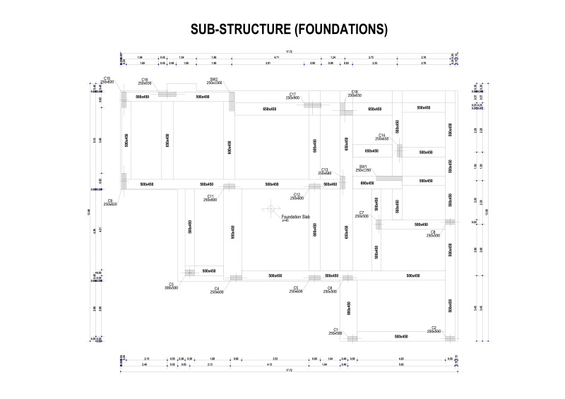

This is the type of foundation i am using, its a monolithic slab (raft foundation) 45cm thick, with foundation beams 45cm height fully embedded within the foundation slab, interconnecting all columns at the base.
Please see link for pictures and more detail

This is a plan view of the foundation beams,
https://res.cloudinary.com/engineering-com/image/upload/v1503952535/tips/Substructure_-_Foundations_rnp7dz.pdf
click the link above for a larger picture

Right. Your foundation model (not considering the slab) would be a bunch of (meshed) stick elements that represent the grade beams. The support for the grade beams would be vertical springs only. If you include lateral loads in your model.....you could just have some horizontal/lateral restraints at the column bases. (And check with hand calculations that you can mobilize enough frictional/passive resistance at those locations to make it valid.)
But all the rotational restraint at your column bases should be from your grade beams.....not any "fixed" support node.
