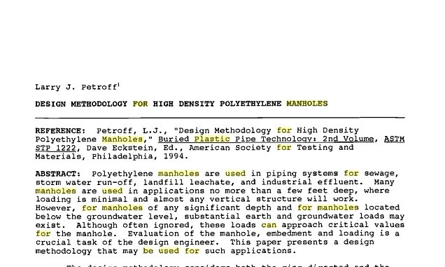

Vertical sump 12 feet from surface to bottom and 4 feet in diameter. Design calls for a SDR of 21. If I am looking at this correctly, on a 48 inch pipe this would require a wall thickness of 2.28” for an SDR of 21. That seems like overkill. Thoughts?

You realize that gravity is a thing, right? Even with 2-1/4 inch wall thickness you have a big problem of the pipe trying to flatten out when lying horizontally and of collapsing when set on end (I wouldn't put any weight on top of piece of 48" HDPE set on end).
Then there is internal forces. If you look at the force over a 1 ft section of this pipe at the ASME B31.8 MAWP of 80 psig you have about 1000 lbf pushing on this plastic pipe. No, 2.28 inches does not seem to be overkill at all.

The rule of thumb for a concrete manhole is 1-Inch thickness per foot of depth. So you can compare the plastic to a 12-Inch thick concrete segment.
RE: SDR Rating for Pipe?
If I understand the OP correctly, this is a sump for a pump. there is likely to be no internal pressure other than 12 feet of standing water, open to atmosphere. It is basically a tank. the main pressure is earth pressure on the outside. Certainly the SDR21 can handle that. I would be worried about flotation more since the SG of HDPE is less than water.

cvg,
You hit e nail on the head. It's to hold back the pressure exerted by the soil. Could probably assume saturated soil being that it's a sump.
