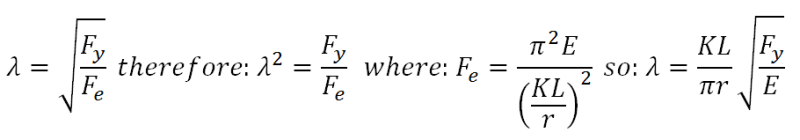

They use Fcr = 0.658 ^ sigma squared FY
They (you?) probably mean lambda, λ, not sigma.
Lambda, λ, is a slenderness parameter and equal to:

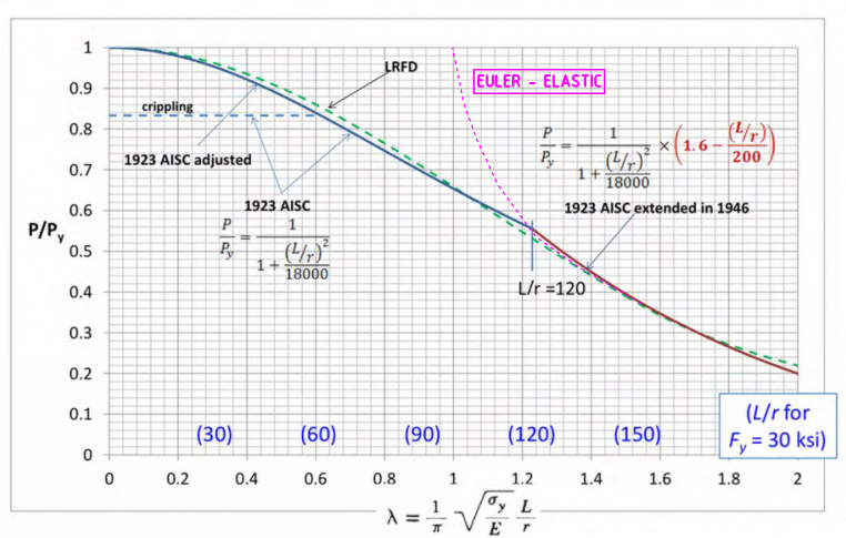

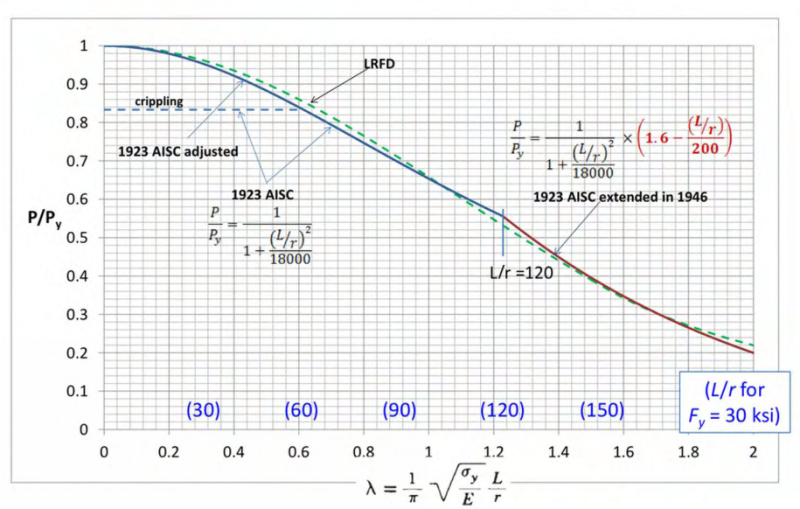

Your design books may be a bit 'old' (relatively - mine are 30 years old smile), but interestingly, the AISC 1923 column curve (extended in 1946) is plotted alongside the LRFD column curve (neglecting ø factors etc.), for Fy = 30 ksi, with extraordinary results. 'Old' is still relevant - even if nearly 100 years old.
Well they both come from Euler's buckling formula, which is a good bit older than 100 years! (260 years old this year)

Quote (IDS)
Agree for L/r > 100 or so (elastic Euler buckling), but for intermediate L/r ratios where INelastic buckling controls, then Euler's 260 year old theory is not appropriate...but I get your point...and Euler was a rockstar!
